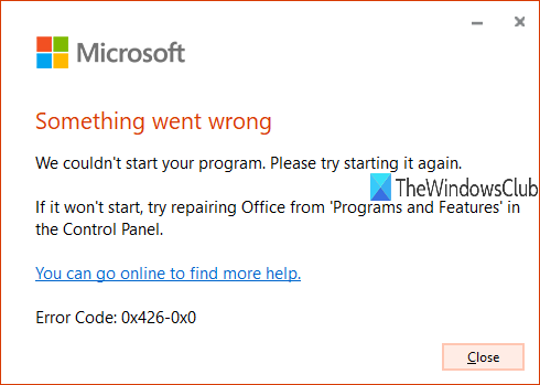

Microsoft Office error code 0x426-0x0 may occur when the installation or update process fails for Microsoft Office or Office 365 when you try to open any of the Office apps (like Word, Excel, PowerPoint, etc.) you cannot launch any program. If you also face such an issue and need some solution, then this post might be helpful.
Fix Office Error Code 0x426-0x0
We have covered some options to help you get rid of this 0x426-0x0 error so that you can launch MS Office apps and install or update Microsoft Office. before you begin, restart your PC and see if it makes the problem go away.

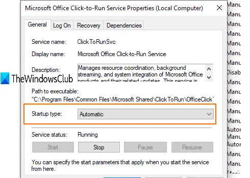

1] Set Microsoft Office Click-to-Run Service to Automatic
If Microsoft Office Click-to-Run Service is disabled, then you won’t be able to launch Office apps. Therefore, you should set its startup type to automatic using Windows Services. For this:
- Type services in the Search box and press Enter
- In the services window, find and double-click on Microsoft Office Click-to-Run Service
- A separate box is opened. There, use the drop-down menu for Startup type and select Automatic.
- Press Start button
- Save the changes.
Now launch some Office app. It should work.

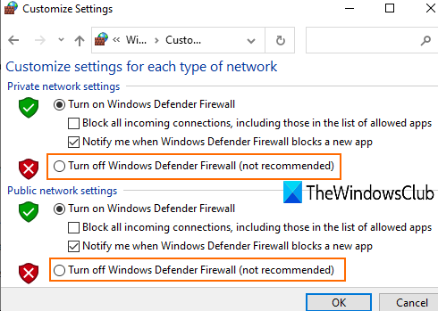

2] Temporarily turn off Windows Firewall
It is possible that Firewall rules set on your computer might be blocking the installation process of Microsoft Office. In such a case, you can temporarily turn on or off Windows Firewall, and retry installing MS Office. If this solves the issue, it’s well and good.

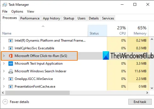

4] End all Microsoft Office Click-to-Run (SxS) processes using Task Manager
There might be some old office related processes that are running silently in the background. Such processes may cause trouble in installing new versions or updates of Microsoft Office. For that, you can take the help of task manager window and close those processes.
- Right-click on the taskbar and use task manager
- Access the Processes tab in Task Manager
- Select Microsoft Office Office Click-to-Run (SxS) process and press the End Task button.
Now you can try to install Microsoft Office or update it.
