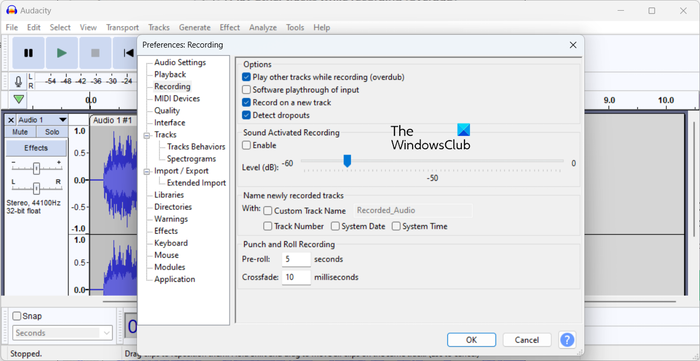

1] Change your Audacity settings
The first thing you can do is check your recording settings in Audacity and make sure they are correctly configured. Incorrect settings in the app can also trigger this problem. So, you can change your settings in Audacity using the below steps:
First, open Audacity and click on the Edit > Preferences option. Or, press the CTRL+P hotkey to quickly open preferences.
Now, move to the Recording tab and set up the options correctly. Enable the Record on a new track, Detect dropouts, and other options accordingly. Plus, adjust the sound level.
When done, press the OK button to save changes.
You can now retry recording sound and see if the problem is fixed.

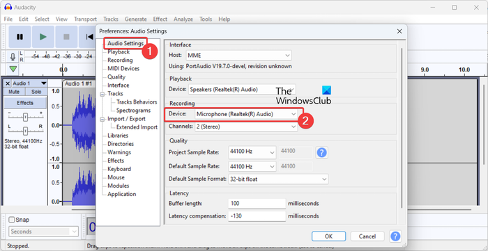

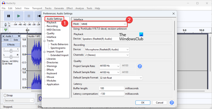

2] Set Audio Host to MME
MME is the default host interface in Audacity used for communicating with different playback and recording devices. It is the most compatible host and works with all audio devices. Now, if the host interface in your Audacity settings has been changed, you might face audio recording issues. So, if the scenario is applicable, you can change the audio host to MME and check if it helps. Here’s how you can do that:
- First, select the Edit > Preferences option or press Ctrl+P to quickly bring up the settings window.
- Now, go to the Audio Settings tab.
- Under the Interface option, set Host to MME and press the OK button to save changes.
- Once done, try recording your voice again and see if the issue is resolved.
Read: Audacity Error opening recording device, Error 9999 Unanticipated host error.
3] Ensure that the correct recording device is chosen
If there are multiple headsets connected to your PC, you must ensure that you have selected the correct recording device in Audacity Preferences. To do that, click on Edit and choose Preferences. After that, from the Audio Settings tab, select the right recording device under the Recording option. When done, click on the OK button and see if the problem is resolved.

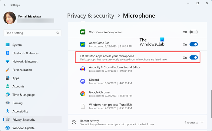

4] Make sure you have granted microphone access in Windows Settings
The problem might be caused if you have not allowed microphone access to Audacity in your Windows Settings. Hence, check your app permission settings and make sure that the microphone access permission is enabled. Here are the steps to do that:
- First, open the Settings app using Win+I.
- Now, go to the Privacy & security tab from the left-side panel.
- Next, under the App permissions section, click on the Microphone option.
- After that, ensure that the toggle associated with the Microphone access option is switched on.
- Then, scroll down to the Let desktop apps access your microphone option, and make sure it is enabled.
Once you have set up the correct settings, open Audacity and you should now be able to record sound in it.

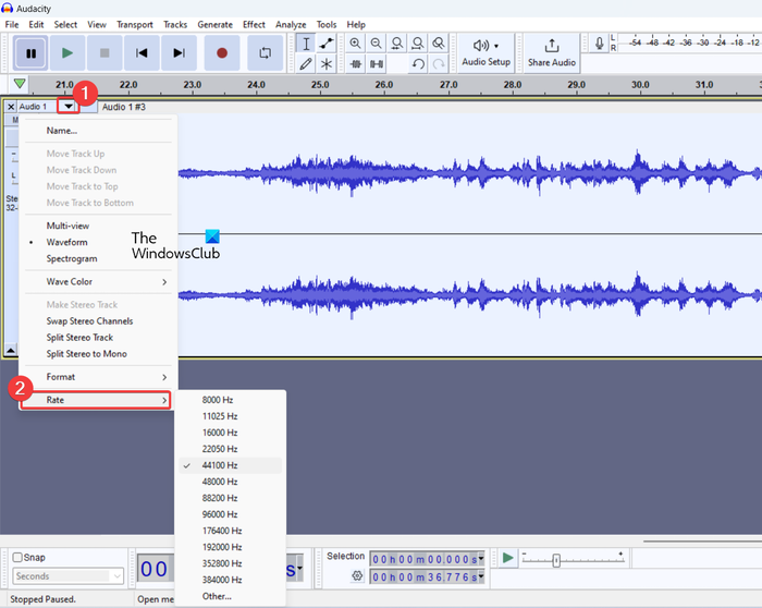

5] Adjust your audio sample rate
If the problem remains the same, you can try changing the audio sample rate and then start the audio recording. 44100 Hz is considered to be a good sample rate for recording audio. However, you can change it accordingly and see what works best for you.
To change the audio sample rate in Audacity, click on the small drop arrow button present at the top of the audio track. After that, go to the Rate option and then choose the desired sample rate. Next, start the audio recording and check if the problem is resolved.

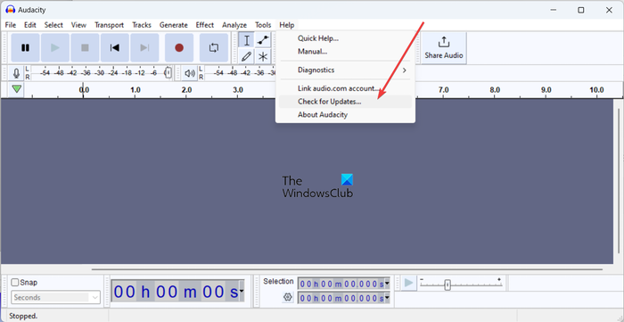

6] Update or Reinstall Audacity
If you are using an older version of Audacity, you might face some performance issues. Hence, update Audacity to the latest version and see if it works. To do that, open Audacity and click on the Help > Check for Updates option. After that, if there are updates available, download the latest version of Audacity and install it on your computer.

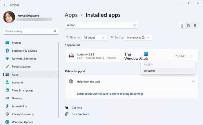

In case updating Audacity doesn’t help, it might be the case that the installation of Audacity is corrupted which is why it is not working correctly. So, if the scenario is applicable, you can reinstall Audacity and see if this helps.
For that, you first need to uninstall Audacity completely from your computer. Open the Settings app using Win+I and move to the Apps > Installed apps section. Next, click on the three-dot menu button present next to Audacity and select Uninstall. Once the program is removed, clear the leftover files associated with Audacity to completely uninstall it. You can then reboot your computer.
On the next startup, download the most recent version of Audacity and then install it on your PC to check if the issue is resolved.
