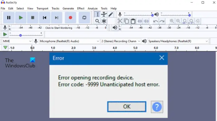

Audacity is a popular and free-to-use digital audio editor and recording application. But while using it on Windows PC, users have reported coming across Audacity Error opening recording device, 9999 Unanticipated host error. If you face this issue, then this post will help you.
The problem occurs while trying to record something on Windows PC. Thankfully, like any other issue, it can be eliminated as well with some simple fixes. Let’s check them out one-by-one.

Audacity Error code 9999 Unanticipated host error
Here are all the effective solutions to try to get rid of Audacity Error code 9999 Unanticipated host error.
