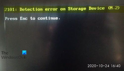

You might see a dark background with the message 2101: Detection error on Storage Device if there is some issue with the CMOS battery, the attached drive, or the BIOS. In this post, we will discuss what to do to resolve this issue.
When you encounter this issue. you’ll receive the following message;
Press Esc to continue.
Upon pressing the Esc key as instructed, the booting sequence restarts before getting stuck at the same error screen.
Bear in mind that in some cases, the first line of the message will specify SSD or HDD as the case may be and that the number indicated may vary. Nevertheless, the solutions presented in this post apply.

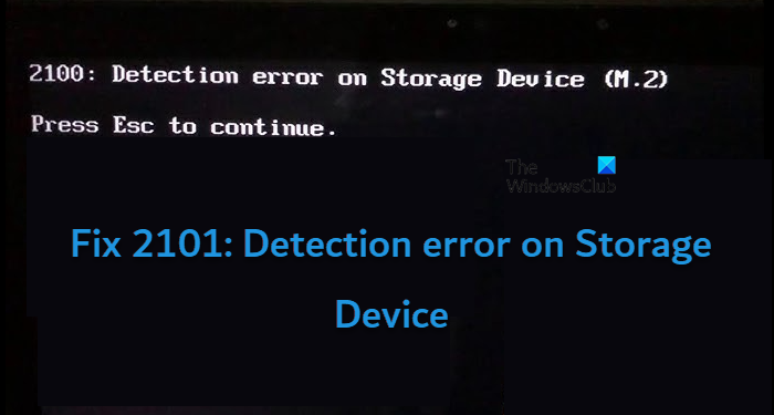

What is error 2100 detection error on storage device?
The 2100: Detection error on HDD0 (Main HDD) is a frequent SSD issue that can stem from various causes. One potential reason could be a defective SSD or incorrect placement of the drive in its slot. To resolve it, go ahead and check out the solutions.
