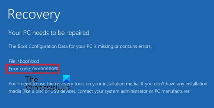

Error Code 0xc00000f0 generally occurs while upgrading Windows Installation, especially from Windows 10 to Windows 11. Users confirm that while upgrading the Windows version, Windows 11 Installation Assistant keeps failing; the screen freezes during the process and then throws this error.
It is generally known to be associated with problems related to the system files required for booting or the Windows Boot Configuration Data (BCD). However, other reasons are also known to contribute to the error. This post will suggest solutions to help you fix the 0xc00000f0 Windows 11 Install or Upgrade error.

1] Resolving Boot Configuration Data issues
As explained in the possible causes section, one of the most prevalent causes of the error can be problems in the Boot Configuration Data (BCD), which is vital to the booting process of the Operating System.
Because the Error Code 0xc00000f0 is primarily a boot error, wherein Windows cannot locate the required files or the configuration data for a successful booting process, fixing BCD issues can majorly help eliminate the problem. The following steps can be taken into consideration for execution to resolve BCD-related issues:
- Boot the system using an external Windows Installation Media like a USB Flash Drive.
- After selecting the preferred language on the given prompt, click on Repair Your Computer.
- Select the Troubleshoot option in the ensuing window and then Advanced Options.
- Select to open Command Prompt, and execute the commands in the same order as mentioned below:
bootrec /fixmbr bootrec /fixboot bootrec /scanos bootrec /rebuildbcd
The bootrec utility initially updates or fixes the Master Boot Record (MBR) using the fixmbr command.
After that, it updates the partition boot sector code with fixboot as the preliminary step in rebuilding the BCD. The next step involves scanning the storage device to locate active OS instances using scanos.
Finally, it executes rebuildbcd to select the particular installation that should be added to the BCD, thereby completing the rebuilding process. Restart the computer for the changes to take effect.
