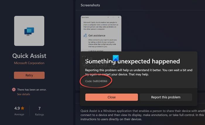

Some Windows 11/10 users failed to install apps from Microsoft Store because of the error code 0x80240066. You may also see this error while installing an update for an app from Microsoft Store. This error code is not associated with a particular app. You may get this error while downloading or installing any app. An unstable internet connection is the most common reason for Microsoft Store apps not getting installed on a Windows PC. Hence, check your internet connection. It will be better if you connect your system to the WiFi via an ethernet cable. If the issue still appears, use the solutions provided below to fix the 0x80240066 Microsoft Store error code while installing apps.
Fix 0x80240066 Microsoft Store error code when installing apps
