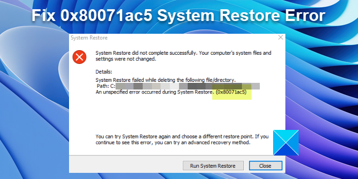

This post will show you how to fix System Restore Error 0x80071ac5 on a Windows 11/10 PC. A few Windows users have reportedly been facing System Restore failures. As they try to roll back their systems to a previous point in time, the restore fails while deleting some files from the system.
These files are often linked with cloud-based services, such as OneDrive, iCloud, etc. The complete error message reads:
System Restore did not complete successfully. Your computer’s system files and settings were not changed.
Details:
System Restore failed while deleting the following file/directory.
Path: C:\Users\OneDrive\1234.
An unspecified error occurred during System Restore. (0x80071ac5)You can try System Restore again and choose a different restore point. If you continue to see this error, you can try an advanced recovery method.
If you’re unable to do a system restore and are getting the same error code, keep reading this post to learn how to fix the issue.

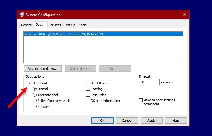

4] Perform a System Restore in Safe Mode
A few users have been able to resolve the issue by performing the System Restore in Safe Mode. Restoring the system from Safe Mode prevents third-party apps and services from conflicting with the process.
Press Win+R and type msconfig in the Run dialogue box. Click on OK. System Configuration window will appear. Switch to the Boot tab.
Select Safe boot under Boot options. Click on Apply and then click on OK. Allow your PC to boot and restart in Safe Mode.
Now type cmd in Windows Search and run the Command Prompt using administrator privileges. Click Yes in the User Account Control prompt.
Type rstrui .exe in the command prompt window and press the Enter key. System Restore window will appear. Click on Next and select the restore point. Click Finish to start performing the system restore.
If the restore succeeds, you may exit the Safe Mode and boot Windows normally (uncheck the ‘Safe boot’ option in the System Configuration window).
