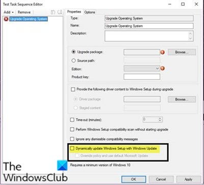

1] Use SCCM to configure OSD to deploy the update
This solution requires you to use System Center Configuration Manager (SCCM) to configure Operating System Deployment (OSD) to deploy the update to resolve the issue of feature updates not installing on Windows devices pointing to intranet location.
ConfigMgr OSD provides an option in the task sequence to override Group Policy settings and point devices to Windows Update during the installation.
To enable this feature, do the following:
- Open the task sequence editor.
- Check the Dynamically update Windows Setup with Windows Update box, as shown in the image above.
- Click Apply > OK to save changes.
