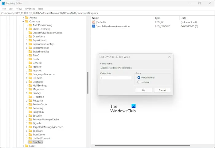

If the above option is missing from Excel Options, you can use a registry tweak to disable hardware graphics acceleration in Excel. However, before doing that, make sure to create a backup of your Registry. Then, follow the below steps:
First, open the Run command box using Win+R and enter regedit in it to open Registry Editor.
Now, navigate to the following folder in the address bar:
HKEY_CURRENT_USER\Software\Microsoft\Office\16.0\Common\
Next, look for a folder named Graphics under the above location. If there is none, create a folder with the Graphics name by right-clicking the Common folder and choosing the New > Key option.
After that, in the Graphics folder, right-click on the right-side pane and select the New > DWORD (32-bit) Value option.
Now, name this newly created DWORD as DisableHardwareAcceleration and then set its value to 1.
Lastly, press the OK button, close Registry Editor, and see if the problem is resolved.

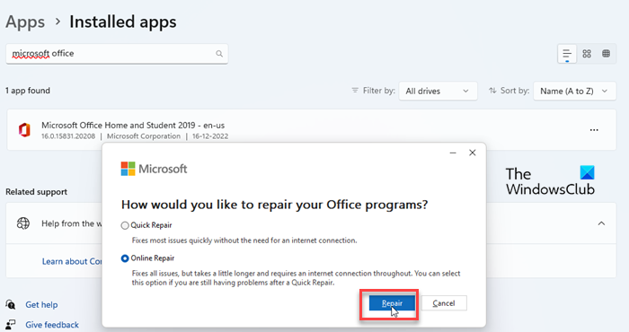

6] Repair Microsoft Excel
It might be your corrupted app causing the issue. So, if the scenario is applicable, repair your Excel app and then reopen it to see if the problem is resolved.
