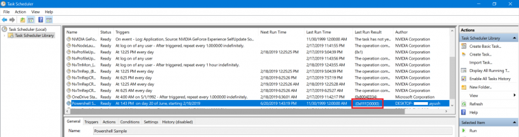

Task Scheduler, the in-built utility in Windows 11/10 is used to schedule tasks and it can be helpful in triggering various instances of a task like an executable file or a script. However, if the Task Scheduler utility has been facing trouble in starting and throwing error 0x80070057, then it could be because of:

For the curious minds, this error is visible under the column of Last Run Result in the Task Scheduler Library.
