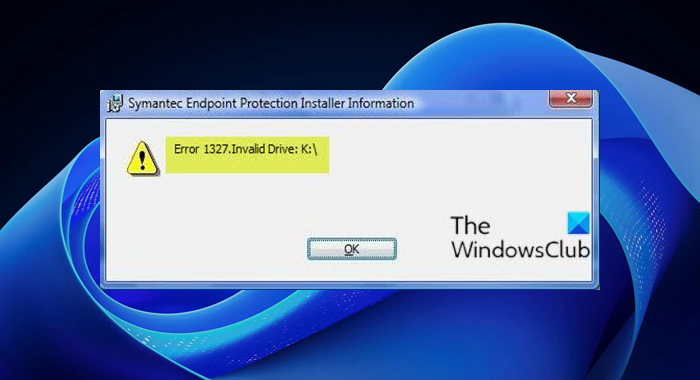

If when you attempt to install or uninstall any program on your Windows 11/10 device, you receive the prompt indicating Error 1327 – Invalid Drive, then this post is intended to help you. Most users will encounter this error during Microsoft Office installation. In this post, we will identify the potential causes, as well as provide the most suitable solutions you can try to effectively resolve the issue.
This error occurs due to the following reasons:
- When the drive being used for the installation of the program is not valid.
- The installer is trying to complete the operation on a network location that is not mapped.

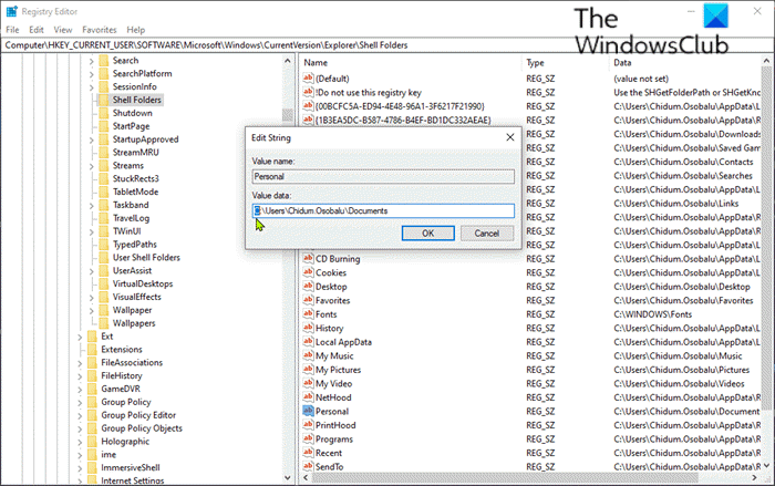

3] Modify the registry
- In the Run dialog box, type
regeditand hit Enter to open Registry Editor. - Navigate or jump to the registry key path below:
Computer\HKEY_CURRENT_USER\SOFTWARE\Microsoft\Windows\CurrentVersion\Explorer\Shell Folders
- On the right pane, identify any entry that has the problematic drive letter shown on the error prompt (in this case
K) and change it to the OS drive (usuallyC). - Once done, click OK to save changes.
- Restart your computer. The issue should be resolved.

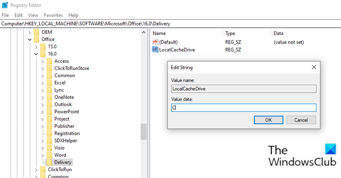

Now, if you’re encountering the problem with an older Microsoft Office installation or when trying to update your current Office installation to a newer version, the issue can also be caused by LocalCacheDrive registry entry that is invalid. In this case, you can fix the issue by modifying the LocalCacheDrive to a valid letter. Here’s how:
Take the necessary precautionary measure, then proceed as follows:
- In Registry Editor, navigate or jump to the registry key path below:
HKEY_LOCAL_MACHINE\SOFTWARE\Microsoft\Office\
- At the location, on the left pane, click the subfolder associated with your Office installation. See table below to compare the first two digits with the corresponding Office suite version.
| First two digits | Office version |
| 11 | Microsoft Office 2003 |
| 12 | Microsoft Office 2007 |
| 14 | Microsoft Office 2010 |
| 15 | Microsoft Office 2013 |
| 16 | Microsoft Office 2016/19 |
- Select the Delivery key.
- On the right pane, double-click on LocalCacheDrive entry to edit its properties.
- In the properties window, set the Value Data to your OS drive (most commonly C).
- Click OK to save the changes.
The issue should be resolved now. Otherwise, try the next solution.

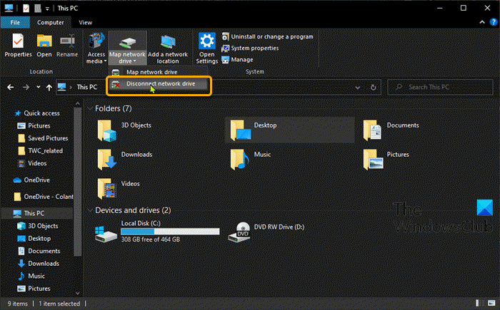

4] Disconnect network drive
Disconnecting the network drive solution will work only if the network drive appears in This PC in File Explorer.
To disconnect the network drive, do the following:
- Press Windows key + E to open File Explorer.
- Click This PC.
- Press CTRL + F1 key to open ribbon with tools.
- Click Map network drive.
- Select Disconnect network drive from the drop-down.
Repeat the action that previously triggered the error and see if the issue has been resolved. If not, try the next solution.
