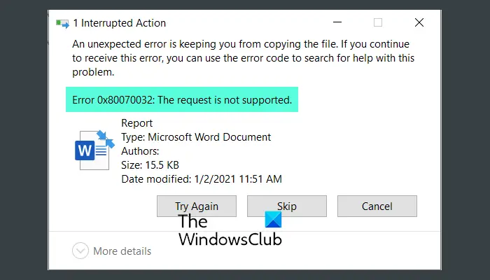

If you get Error 0x80070032, The request is not supported error when copying files on Windows 11/10, here is how you can fix the issue. It could happen for various reasons, and this article explains all the possible solutions so you can get rid of the error in moments.
An unexpected error is keeping you from copying the file. If you continue to receive this error, you can use the error code to search for help with this problem.
Error 0x80070032: The request is not supported.
It could happen to any file, such as documents, music, video, or images. If this error message appears on your screen, you won’t be able to copy the file from one folder to another in any way.
Error 0x80070032, The request is not supported when copying files
