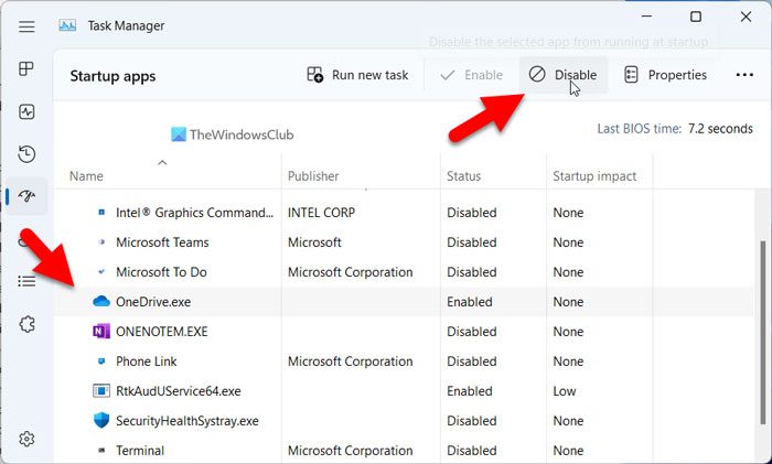

1] Remove Startup programs
It is the first thing you must do when your Disk usage is stuck at 100%. At times, some people forget to check the startup apps list frequently. If that happens to you too, you might encounter the same issue. As startup apps consume a lot of Memory and other CPU resources, you need to remove or diable Startup programs to make the disk usage lower than 100%.
To remove apps from startup, follow these steps:
- Press Ctrl+Shift+Esc to open the Task Manager.
- Switch to the Startup apps tab.
- Find the Enabled apps and select them.
- Click on the Disable button.

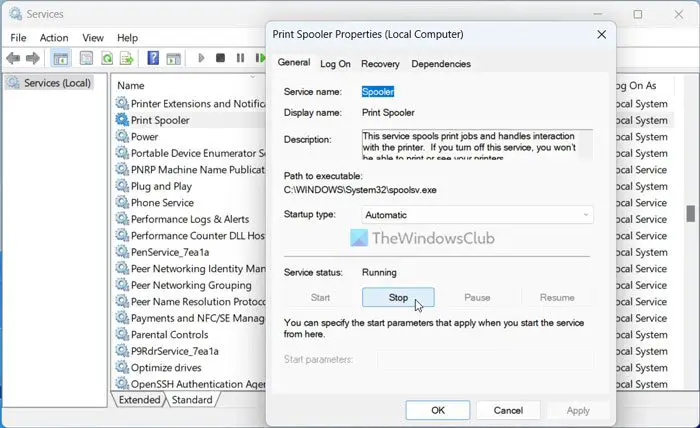

4] Turn off Print Spooler service temporarily
Print Spooler service is essential for all printer users. This in-built service mainly stores data or pending printing jobs. Even if you shut down your computer, it doesn’t remove the stored data. That is why it needs some disk space to store your data. To turn off the Print Spooler service in Windows 11/10, follow this detailed guide.
