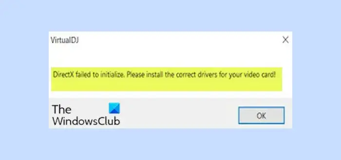

Some PC users after installing the Virtual DJ or any such software on their Windows 11/10 PC, get the error message DirectX failed to initialize, Please install the correct drivers for your video card, even though their computer graphics card is DirectX capable. This post offers the most suitable solutions to resolve this issue.
The normal reason for this DirectX error is because your computer for whatever reason thinks that your graphics card does not support DirectX even though it does.
If you’re faced with this issue, you can try our recommended solutions below in no particular order and see if that helps to resolve the issue.
