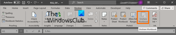

2] Turn off the sharing of the workbook
If the above solution didn’t work, it might be because your workbook is shared. If the workbook you are using is shared with others, you won’t be able to delete a worksheet. Hence, if the scenario is applicable, unshare the workbook and then check if you can remove a worksheet using the Delete option.
Here’s how to do that:
First, open the problematic Excel workbook and then move to the Review tab present on your ribbon.
Now, click on the Unshare Workbook option and unshare the workbook.
You can now right-click on a worksheet and press the Delete button to remove it.
