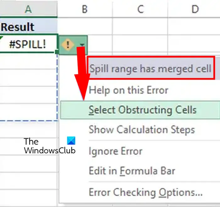

2] Spill range has merged cells
The next error message is “Spill range has merged cells.” As the message indicates, the cause of #SPILL! error is that there are merged cells within the spill range that don’t work with spilling.
If this scenario is applicable to you, unmerging the cells causing the error is the solution. Here are the steps to do that:
- First, select the warning sign present next to the #SPILL! error.
- Now, from the appeared options, choose the Select Obstructing Cells option.
- You will now be shown the problematic cells that are merged.
- Next, you can unmerge the blocking cells. For that, go to the Home tab and click on the Merge & Center down arrow.
- After that, choose the Unmerge Cells option.
Besides unmerging the problematic cells, you can also move the formula to a column without merged cells.

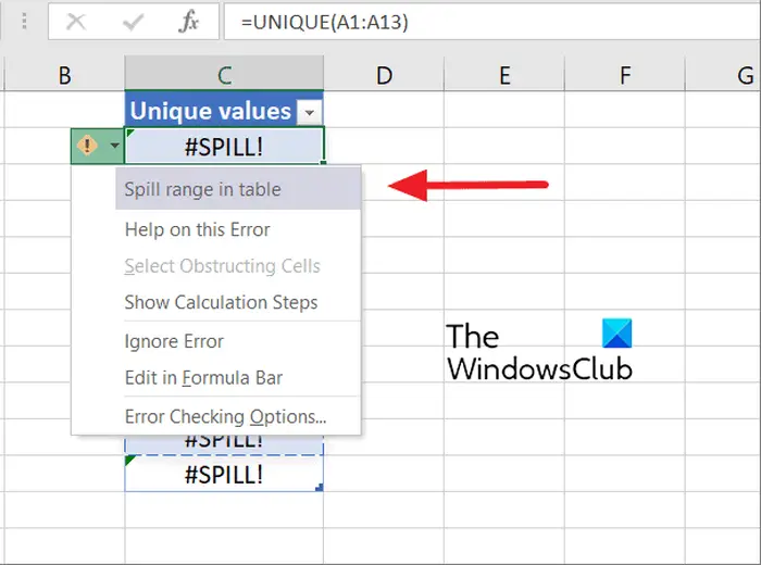

3] Spill range in table

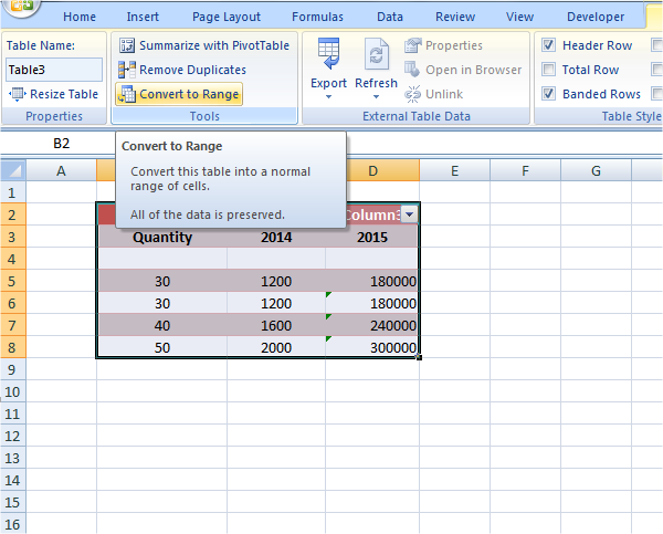

If you get the error message “Spill range in table” with the #SPILL! error, the reason behind it is that the Excel tables do not support dynamic or spilled array formulas. Now, if you want to fix the error in this case, you need to convert the table into a normal range. Or, you can also try placing the formula out of the table to let it spill.
To convert the table to a range, you can press the right-click anywhere within the table. After that, from the appeared context menu, select the Table > Convert to Range option. Or, click inside the table, go to the Table Tools > Design option on the ribbon, and choose the Convert to Range button from the Tools group. This will fix the error for you. Besides that, you can just move the formula out of the table.

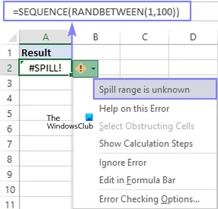

4] Spill range is unknown
Spill range is unknown is another warning message linked with the #SPILL! error in Microsoft Excel. The primary reason for this error message is that the size of the spill range is unknown by Excel.
Voltauke functions (RAND, TODAY, RANDBETWEEN, etc.) with dynamic functions might throw a #SPILL! error as the “wrapper” function is unable to determine the size and how many values to generate.
So, in that case, the workaround is to change the formula that you are currently using for the task. You can try using a different combination of formulas that will compute the same values without #SPILL! error.

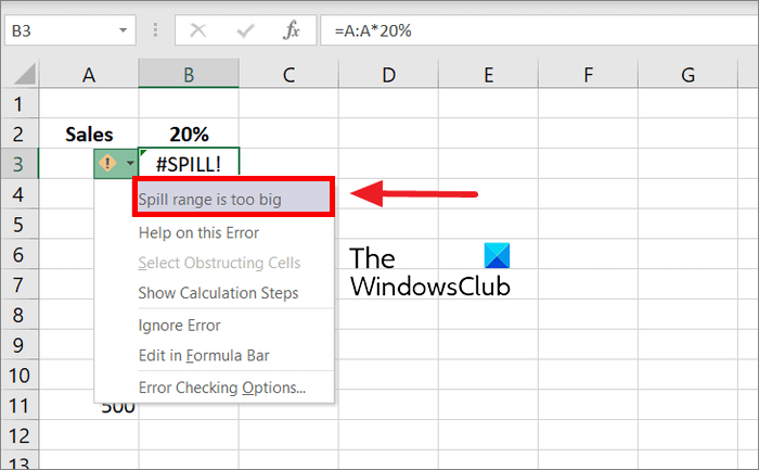

5] Spill range is too big
If you are getting the Spill range is too big error message, the output exceeds the edges of the worksheet. In that case, you can follow the below approaches to fix the error:
- You can reference only the specific lookup values you need (e.g.,
=VLOOKUP(A2:A7,A:C,2,FALSE)). While this formula type generates a dynamic array, it is incompatible with Excel tables. - You can simply reference the value within the same row and copy the formula downwards. It is a conventional formula style that functions properly in tables. However, it does not generate a dynamic array.
- You can perform the implicit intersection using the “@” operator in your formula and copying it downwards (e.g.,
=VLOOKUP(@A:A,A:C,2,FALSE)). It doesn’t return a dynamic array but works in tables.
