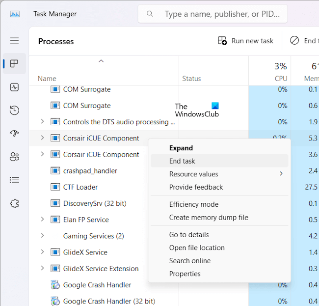

1] Close the iCUE software and relaunch it
The first thing that you should do is close the iCUE software completely and then relaunch it. Follow the steps provided below:
- Close the iCUE software.
- Open the Task Manager and select the Processes tab.
- Look for the Corsair iCUE processes running in the background.
- Right-click on each iCUE process and select End task.
After performing the above steps, launch the iCUE software. Now, see if it detects the RAM or not.

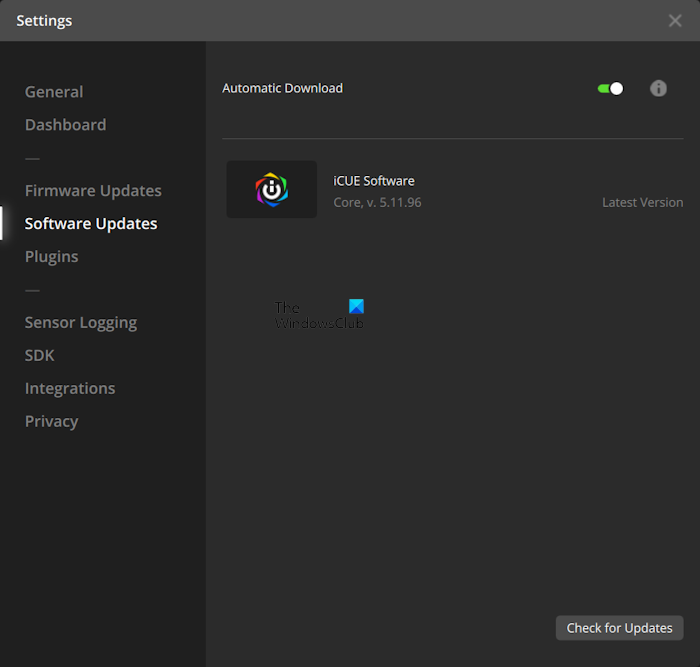

2] Check for software updates
Make sure that you are using the latest version of the Corsair iCUE software. Follow the steps provided below to check for software updates:
- Open the iCUE software.
- Click on the gear-shaped icon on the top right side to open its settings.
- Select Software Updates from the left side.
- Now, click on the Check for Updates button.
After performing the above steps, the software will check for updates and install the same (if available).

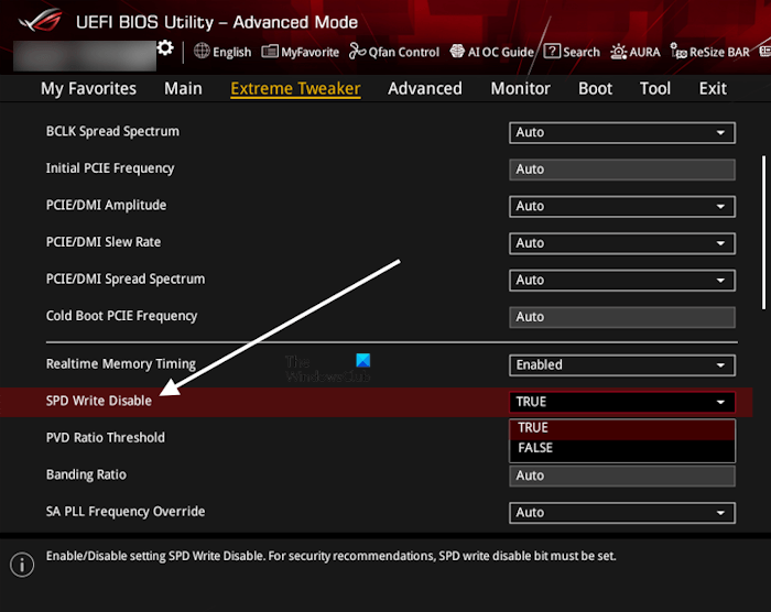

4] Does your motherboard have an SPD Write feature?
If your motherboard has an SPD Write feature, it should be enabled. Otherwise, the Corsair iCUE software will not detect your RAM sticks. Refer to the user manual to know if your motherboard has this feature. Also, the method to enable this feature is mentioned in the user manual of your motherboard.
