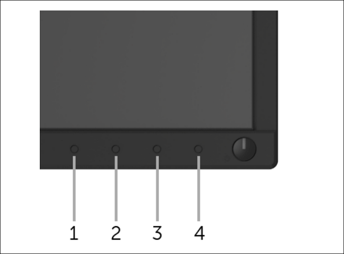

2] Check your monitor physical controls
You should also check the physical controls on your monitor. They might be the cause of the problem. For information on the functions of physical controls, refer to your monitor’s user manual.
