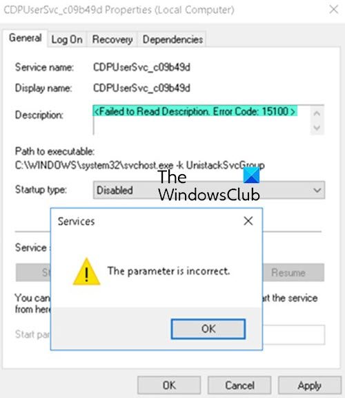

CDpusersvc Failed to Read Description, Error Code 15100
If when you open Services Manager, locate the Connected Devices Platform Service, and open its Properties box, you see Failed to Read Description, Error Code 15100 in Description, then it could be caused due to file corruptions. This can cause high CPU & memory usage

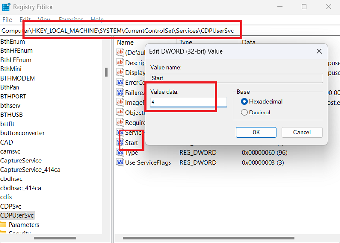

1] Registry level fix
Many users claimed that the best fix which worked towards solving the problem is to disable the CDPUserSvc service through the Registry Editor. The procedure is as follows:
- Press Win+R to open the Run window.
- In the Run window, type the command REGEDIT and hit Enter. This will open the Registry Editor window.
- In the Registry Editor window, go to the path HKEY_LOCAL_MACHINE\SYSTEM\CurrentControlSet\Services\CDPUserSvc.
- In the right pane, double-click on the DWORD (32-bit) entry named Start.
- Change the value of the Value Data from 2 to 4.
- Click on OK to save the settings.
- This will disable the CDPUserSvc process.
When the Value data was set at 2, the CDPUserSvc service and associated files were enabled. When you changed the Value data to 4, the process got disabled.

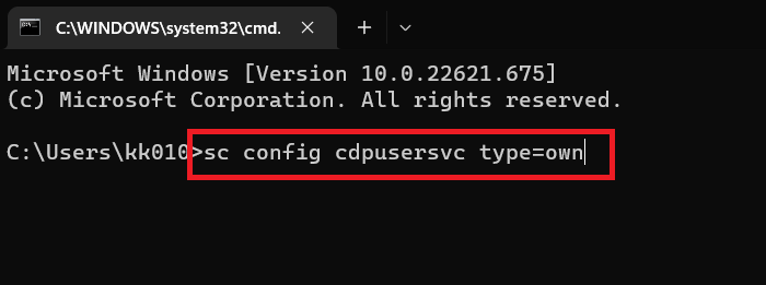

2] Command Prompt fix
The second solution is through the elevated Command Prompt window. The purpose is to isolate the service and check whether it fixes the problem or not. The procedure is as follows:
- Search for Command Prompt in the Windows Search bar.
- Click on Run as administrator in the right pane to open the elevated Command Prompt window.
- In the elevated Command Prompt window, copy-paste the following command and hit Enter to run the same.
- sc config cdpusersvc type=own
- Check if this resolves the problem in the discussion.
The SC command means Service Control and in the example mentioned above, this command stops the CDPUserSvc service.

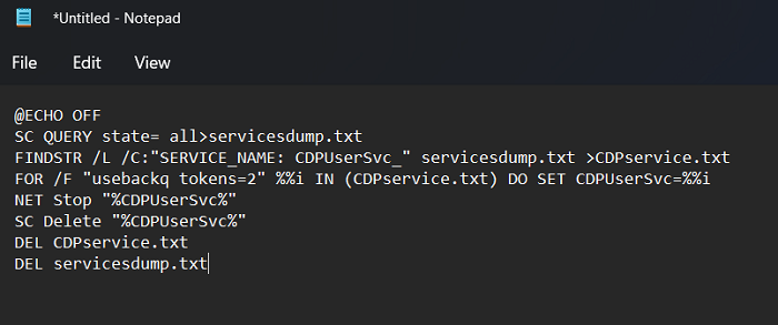

3] Run a .BAT file
You can stop the CDPUserSvc process completely using a .BAT file. The procedure is as follows:
Open a blank Notepad window.
In this blank Notepad window, copy-paste the following set of commands.
@ECHO OFF SC QUERY state= all>servicesdump.txt FINDSTR /L /C:”SERVICE_NAME: CDPUserSvc_” servicesdump.txt >CDPservice.txt FOR /F “usebackq tokens=2” %%i IN (CDPservice.txt) DO SET CDPUserSvc=%%i NET Stop “%CDPUserSvc%” SC Delete “%CDPUserSvc%” DEL CDPservice.txt DEL servicesdump.txt
Now, click on File >> Save as.
Select the Save as type to All files.
Name the file StopCDPUserSvc.bat.
Click on Save to save the file at the destination of your choice.
Now, double-click on the file to execute the set of commands.
Unlike the Command Prompt method, the .BAT file performs multiple actions. This includes stopping the CDPUserSvc service and deleting log files associated with it.
