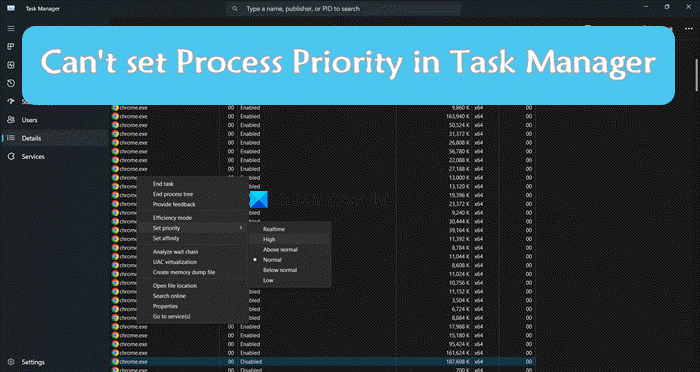

Windows tends to automatically allocate priority to the applications but it allows the user to manually send the priority. However, we have noticed that sometimes, we can’t set Process Priority in the Task Manager. In this post, we will see how to resolve this issue.
The higher the priority level, the more resources Windows reserves for the program. Although not advisable, increasing the priority level is a temporary solution that works for most users. However, in some cases, when you try to change the Process Priority in Task Manager, it fails, and you get the error that says Access denied.
If you experience this on a specific process, then it is an issue that stems from the program in question, and you can’t fix that (for the good of your computer). On the other hand, if you can’t set the priority level of multiple processes, read this guide to the end to learn how to repair the issue and force your computer to let you change process priority levels.
Can’t set Process Priority in Task Manager of Windows 11/10
If your Windows system doesn’t let you change the priority levels of programs using Task Manager, below are the troubleshooting steps to fix the issue.
