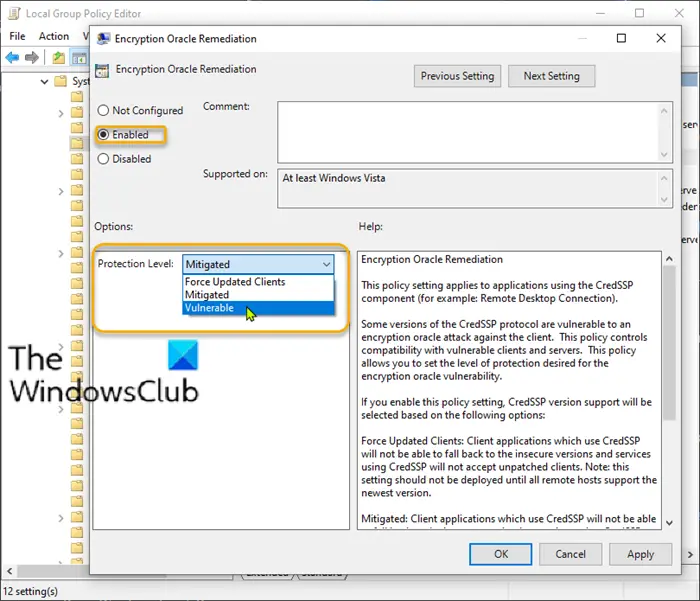

2] Modify the Encryption Oracle Remediation policy
The error message can be resolved by using the Group Policy editor to modify the Encryption Oracle Remediation policy.
Note: This method does not apply to Windows Home edition because the Local Group Policy Editor is not installed by default. But you can work around this issue by adding Local Group Policy Editor to Windows Home edition.
To enable the Encryption Oracle Remediation policy, do the following:
- Press Windows key + R.
- In the Run dialog box type gpedit.msc and press Enter to open Group Policy Editor.
- Inside the Local Group Policy Editor, use the left pane to navigate to the path below:
Computer Configuration > Administrative Templates > System > Credentials Delegation
- On the right pane, double-click on Encryption Oracle Remediation to edit it’s properties.
- With the Encryption Oracle Remediation policy opened, set the radio button to Enabled.
- Next, scroll down to Protection Level and change it to Vulnerable.
- Click Apply > OK to save the changes.
You can now exit the Local Group Policy Editor and restart your computer. On boot, try the RDP connection again and see if the issue is resolved.

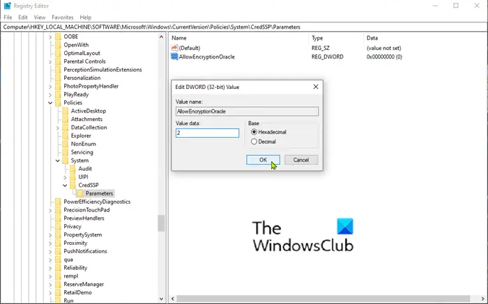

3] Create and configure the AllowEncryptionOracle registry key
This is the equivalent of enabling the Encryption Oracle Remediation policy. You can resolve the issue by creating and configuring the following registry key:
AllowEncryptionOracle: DWORD: 2
Since this is a registry operation, it is recommended that you back up the registry or create a system restore point in case the procedure goes wrong.
Once you have taken the necessary precautionary measures, you can proceed as follows:
- In the Run dialog box, type regedit and press Enter to open Registry Editor.
HKEY_LOCAL_MACHINE\SOFTWARE\Microsoft\Windows\CurrentVersion\Policies\System
- Right-click System, select New > Key and set its name as CredSSP.
- Next, right-click CredSSP, select New > Key and set its name as Parameters.
- Now, right-click on the blank space on the right pane and then select New > DWORD (32-bit) Value.
- Rename the value name as AllowEncryptionOracle and hit Enter.
- Double-click on the new value to edit its properties.
- Input 2 in the Value data box and press Enter to save the change.
- Exit Registry Editor and restart you PC.
You should now be able to establish the Remote Desktop Connection successfully!
