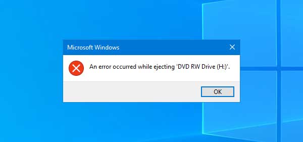

When you try to eject a CD or DVD, you see a message – An error occurred while ejecting DVD RW Drive, then this post offers some suggestions that may help you resolve the problem. It mainly happens due to a hardware issue, but it can also occur for different reasons.
The Drive letter will be mentioned in the error message, which could be H, E, D, etc. Before troubleshooting, you should install the latest version of your CD/DVD driver.

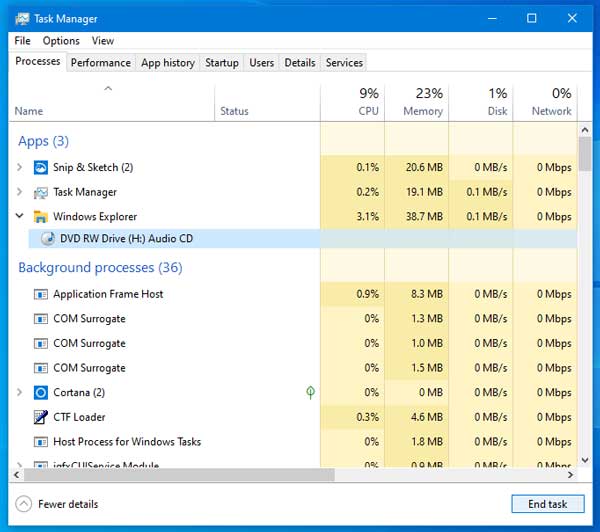

1] Close the running task from Task Manager
If the DVD writer is not ejecting your CD or DVD, it can mean that some other program is using it currently. You need to close that task from Task Manager so that the internal link between that running program and the CD/DVD can be broken, and you can eject the CD.
To do that, open your Task Manager and expand the Windows Explorer section. You should see the name of your CD or DVD and the drive letter. For example, DVD RW Drive (H:) Audio CD is visible in the image.
Please select it and click the End task button. Following that, try to eject the CD/DVD.
