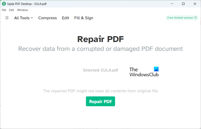

3] Repair the corrupted PDF
This error could very well be facilitated if your PDF file is corrupted. Hence, in that case, you can repair the corrupted PDF files. Now, the question arises how? Well, there are several third-party tools like PDF Fixer Tool that enable you to fix a damaged PDF file.
You can also use the Sejda PDF Desktop app. It provides a dedicated Repair function using which you can easily fix broken PDF files.
To do that, download and install Sejda from its official website. After that, run the app and from its home screen, click on the Repair option which is present in the Other category. Next, browse and select the problematic PDF file and then press the Repair PDF button. Now, provide the path to the output PDF and enter the filename to start the process. It will then start repairing the corrupted PDF and recover the last data.
This free PDF repair tool can be downloaded from sejda.com. The good thing is that it also provides an online tool to repair PDFs. You can open the website in a web browser, upload the input PDF which is corrupted, and then press the Repair PDF button to fix the damaged PDFs.
In case the PDF file is fine yet you receive this error, we suggest you use the next fix.
