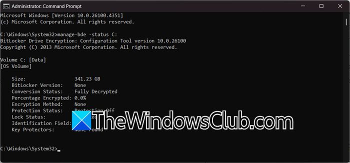

2] Check BitLocker conflict
If your backup is copied at the destination, we need to investigate further. First, let’s check if there is any BitLocker conflict that may be causing the backup to be configured incorrectly. To do so, open the Command Prompt as an administrator and run the following command.
manage-bde -status C:
Now, you need to check if the Drive is encrypted with BitLocker. If it’s encrypted, you need to unlock it before using its backup. For that, run the following command.
manage-bde -unlock C: -RecoveryPassword YOUR-48-DIGIT-KEY
Finally, configure backup and see if the issue is resolved.
