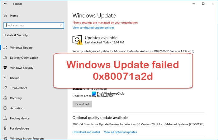

Some Windows users may encounter the error code 0x80071a2d when trying to update Windows operating system to the latest version or build. If you’re facing a similar issue, you can try the solutions provided in this post to successfully resolve the issue.
Fix 0x80071a2d Windows Update error
If you’re facing this issue, you can try our recommended solutions below, which are listed in no particular order, and see if they help to resolve the issue.

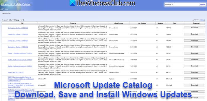

3] Manually download the update from Microsoft Update Catalog
In this case, if you’re having issues downloading and installing updates via the Windows Update, you can manually download the update from the Microsoft Update Catalog and then run the standalone installer to install the update on your Windows device.
