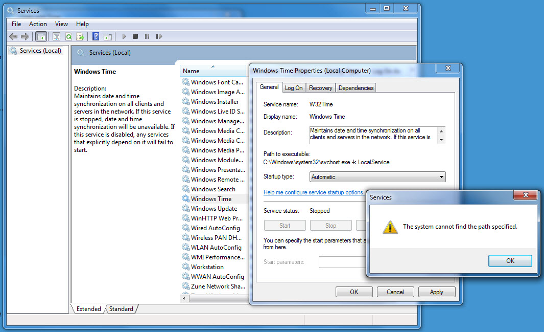

Windows Time service fails to start with Error 1079
If you find that the Windows Time service fails to start with Error 1079, you may want to ensure that the service is being started by the Local System account instead of by the Local Service account (NT AUTHORITY\LocalService). More details on this here.
The system cannot find the path specified
You get an error box: The system cannot find the path specified.
In such a case, you may want to re-register dll file. The concerned dll file here is w3time.dll. To do so, open a command prompt as an Administrator, type regsvr32 w32time.dll and hit Enter.

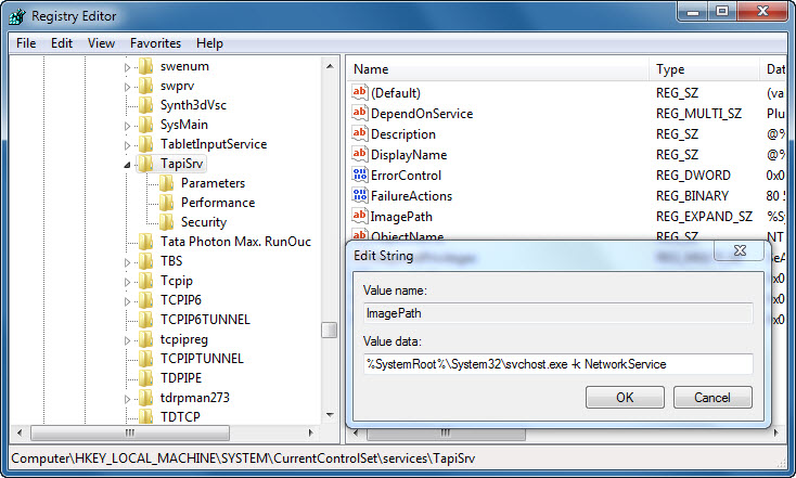

In such an eventuality, you will have to open your Registry Editor.
Once you have opened regedit, navigate to the following registry key:
HKLM\HKEY_LOCAL_MACHINE\SYSTEM\CurrentControl\services\TapiSrv
Now in the right pane right-click on ImagePath and select Modify. Here in the Value data box, make sure that the value is:
%SystemRoot%\System32\svchost.exe -k NetworkService
Click OK and exit.
