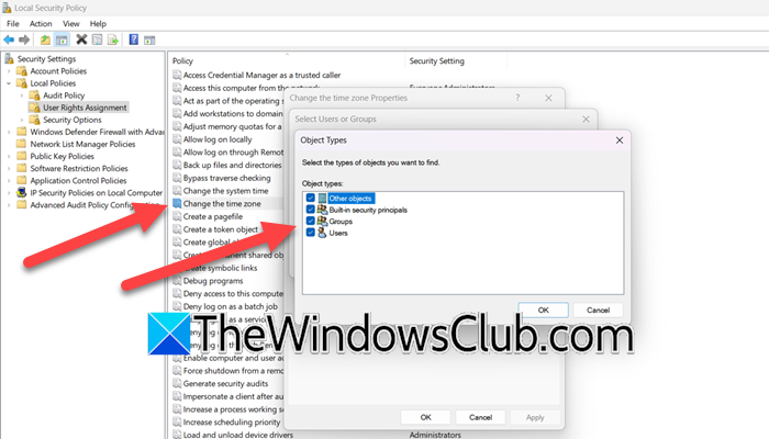

2] Give the user the privilege to change the time zone
If you are able to change the time zone with the admin account, you are lucky, as you are not facing any issues; it’s just that your organization doesn’t allow standard users to change the time zone. However, if you are a server admin and want to allow a standard user to change the time zone, follow the steps below.
- Open the Local Security Policy on the server by searching it out of the Start Menu.
- Now, navigate to Security Settings > Local Policies > User Rights Assignment.
- Scroll and look for the Change time zone policy.
- Double-click on it to open and then click on Add Users or Group.
- Click on Object types, tick Groups from Object types, and then click on Ok.
- Then, in the Enter the object names to select field, enter the word Users and click OK on the rest of the boxes until they go away.
- Click on Apply > Ok.
After making the aforementioned changes, you can close the window and then restart your machine. Once done, check if the issue is resolved.

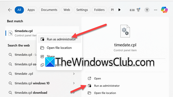

3] Run timedate.cpl as an administrator
When we tried to change the time zone in the Control Panel, we encountered the error in question. So, ideally, we went to Settings, but even then, we received an error forbidding us from making the changes. What’s happening here is that, even though the account has admin privileges, the date and time change option doesn’t open for an admin. So, you need to hit Win + S, type “timedate.cpl”, right-click on the entry, and select Run as administrator, alternatively, click on the Run as administration option that’s on the right section. Click Yes when the UAC prompt appears and then change the time zone. Hopefully, it will do the trick for you.

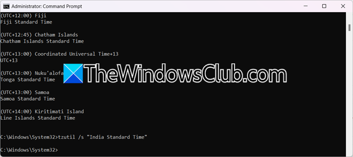

4] Change the time using the tzutil command
The tzutil command in Windows is a utility for managing and configuring the system time zone. It stands for “Time Zone Utility” and allows users to display, set, and list time zones via the command line. If you cannot change the timezone using the method mentioned earlier, try this alternative. To do so, open the Command Prompt as an administrator.
Now, run the following command to list all available time zones.
tzutil /l
Once you have the list of time zones, note the name of the time zone you want to select, then run the following command.
tzutil /s "India Standard Time"
You need to replace “India Standard Time” with the correct time zone ID as per your preference.

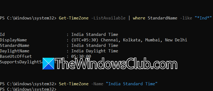

5] Use the Set-TimeZone command
Alternatively, you can use the Set-TimeZone command in PowerShell to set a time zone. To do so, open PowerShell as an administrator and then run the following command.
Get-TimeZone -ListAvailable
This will give you a list of all the available time zones. However, if you want to narrow down your search, you can use the pipeline (|) to add the filter. So, the command would look something like Get-TimeZone -ListAvailable | where StandardName -like "*Ind*". You can replace “Ind” with your country name.
Then, run the following command to set the time zone.
Set-TimeZone -Name "ID"
Replace “ID”, with the ID of your time zone, so, in my case, the command will be Set-TimeZone -Name "India Standard Time".
