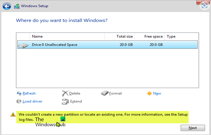

During a clean install of Windows on your device with the Custom option, you may get the error message We couldn’t create a new partition or locate an existing one. This post is intended to help affected PC users with solutions and suggestions to get past this installation issue.
We couldn’t create a new partition or locate an existing one. For more information, see the Setup log files.
Windows Setup couldn’t create a new partition or locate an existing one
If you get the We couldn’t create a new partition or locate an existing one when you try to clean install Windows 11 or Windows 10 on your device, you can try the recommended solutions in the order presented below to resolve the issue on your system.

1] Refresh the Windows installation
The first step you can take to quicky and easily resolve the We couldn’t create a new partition or locate an existing one when you try to clean install Windows 11/10 on your device is, to give the installation a quick refresh. To perform this task, do the following:
- Unplug any USB external drive.
- While in the Windows installation error dialog, unplug the Windows installation USB from the PC and wait for 15 to 30 seconds.
- Plug the USB back to the PC and click on Refresh.
Now, see if you can proceed with the OS installation without issues. Otherwise, try the next solution.
Read: Windows 11 won’t install [Fixed]

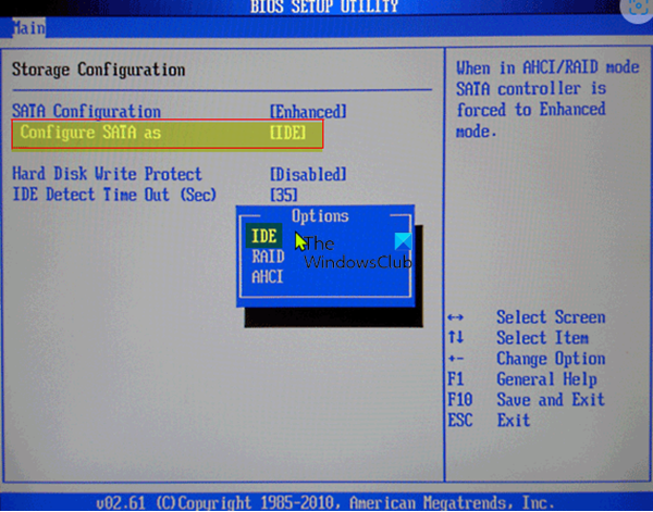

2] Change SATA configuration in BIOS
You may encounter this issue if the HDD controller mode is set to AHCI or RAID and the system lacks appropriate drivers. In this case, to fix the problem, the disk controller must be interchanged to IDE. For this task, you have to boot into BIOS and make the required changes by following proper guidelines. You can find the proper guidelines in the instruction manual of the motherboard supplied at the time of buying it or check on the internet.
Read: Windows was unable to create a required installation folder, Error 0x8030002F
