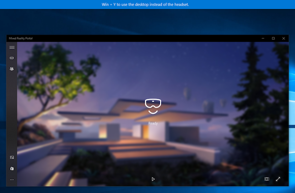

Windows Mixed Reality is not working
If Windows Mixed Reality is not working, not downloading, or there is no sound or display, then this troubleshooting post will help you fix Mixed Reality problems & issues.
