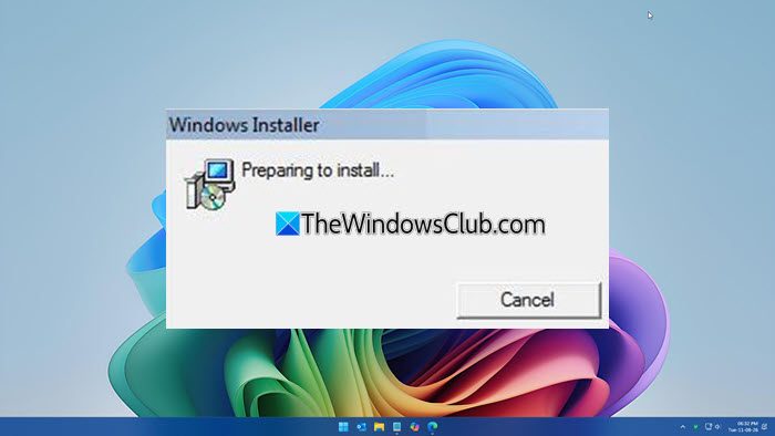

Does your Windows Installer process run every time you boot the Windows 11/10 device? Or maybe you are working, and it suddenly pops up randomly? Why does this happen? How do you stop it from running at random times in the background? This post takes a look at some scenarios & discusses your options.
Windows Installer Preparing to install
The Windows Installer or msiexec.exe is a Windows OS component and an application programming interface, located in the System32 folder, that is used for the installation, maintenance, and removal of software. So when you see this process running, it definitely means that some software is being installed, changed, or uninstalled. Many software programs use the Windows Installer to carry out the installation process.
Windows Installer keeps popping up
