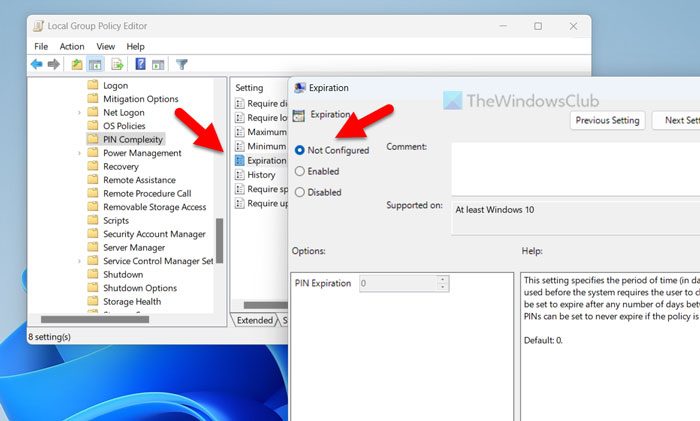

1] Verify PIN expiration setting
It is possible to set an expiry date for the PIN so that your organization always stays on the safe side. If the date is over, users need to use a new PIN. At times, this setting could cause the cause in different ways. That is why it is suggested to turn off the PIN expiration setting for a while and check if it resolves your problem or not. For that, do the following:
- Type gpedit.msc and hit the Enter button.
- Go to this path: Computer Configuration > Administrative Templates > System > PIN Complexity.
- Double-click on the Expiration setting.
- Choose the Not Configured option.
- Click the OK button.

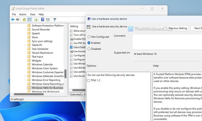

3] Enable use of a hardware security device
A PIN is the most commonly used way to sign into a computer protected with Windows Hello for Business. However, it requires TPM to get the job done. If a computer is not equipped with Trusted Platform Module 1.2 or 2.0, you may not be able to use Windows Hello for Business. As an administrator, if you want to allow all the computers to use this security setting, you can enable or disable this setting in the Local Group Policy Editor. For that, do the following:
- Open the Local Group Policy Editor.
- Go to this path: Computer Configuration > Administrative Templates > Windows Components > Windows Hello for Business.
- Double-click on the Use a hardware security device setting.
- Choose the Enabled option.
This solution works only when you have enabled it earlier. Also, do not select the Disabled option.

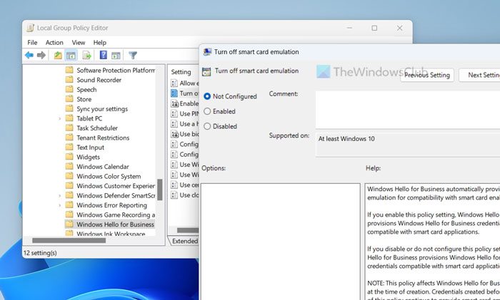

4] Turn on smart card emulation
Some Windows apps use smart cards to allow you to use Windows Hello for Business. However, if your credentials do not comply with smart card apps, you cannot use them to sign in. There is a Group Policy setting that prevents administrators from disabling smart card emulations for Windows Hello for Business. You need to turn it on using these steps:
- Navigate to this path: Computer Configuration > Administrative Templates > Windows Components > Windows Hello for Business.
- Open the Turn off smart card emulation setting.
- Double-click on the Allow enumeration of emulated smart card for all users setting.
After that, try Windows Hello for Business on your computers.

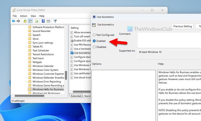

5] Turn on biometrics for Windows Hello for Business
By default, Windows Hello and Windows Hello for Business use PIN as the primary method of login. However, it is also possible to use biometrics gestures to do the same thing. This Group Policy setting allows or prevents users from using biometrics. Therefore, it is suggested to follow these steps to verify the setting:
- Open Local Group Policy Editor.
- Go to this location: Computer Configuration > Administrative Templates > Windows Components > Windows Hello for Business.
- Double-click on the Use biometrics setting.

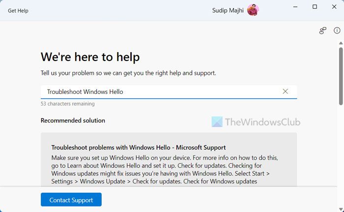

6] Use Get Help to troubleshoot
If none of the aforementioned solutions has worked for you, it is time to use a Troubleshooter. You can use Get Help to use Windows Hello for Business Troubleshooter. Although we have covered most solutions here, there could still be a few things left, depending on the unique situation you are in. To use Get Help, follow these steps:
- Search for get help in the Taskbar search box.
- Click on the individual search result.
- Type troubleshoot windows hello in the search box.
- Follow the solutions as mentioned in the Get Help app.
