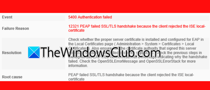

During the EAP-TLS authentication process with ISE, we encountered an error indicating that authentication had failed. Due to this, we fail to deploy a network access solution for the organization as it relies on Cisco ISE for the same. In this post, we are going to see what to do see what to when Windows machines fail to complete EAP-TLS authentication with ISE.
Event 5400 Authentication failed.
Fix Windows 11 machines fail to complete EAP-TLS authentication with ISE
If Windows machines fail to complete EAP-TLS authentication with ISE, with Event 5400 Authentication failed error, follow the solutions mentioned below.

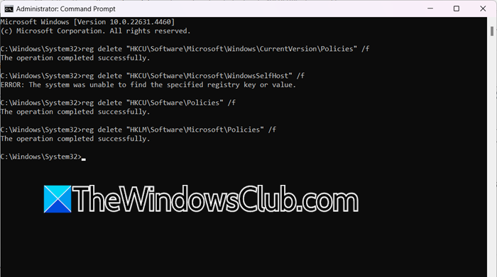

1] Delete registry entries
Usually, this issue is a result of the fact your Group Policy is not selecting Root and Intermediate certifcates. In order to resolve the issue, we are required to delete a few registry entries. However, before doing that, you should take a backup of registry entries. Once done, open the Command Prompt as an administrator and then run the following queries.
reg delete "HKCU\Software\Microsoft\Windows\CurrentVersion\Policies" /f reg delete "HKCU\Software\Microsoft\WindowsSelfHost" /f reg delete "HKCU\Software\Policies" /f reg delete "HKLM\Software\Microsoft\Policies" /f reg delete "HKLM\Software\Microsoft\Windows\CurrentVersion\Policies" /f reg delete "HKLM\Software\Microsoft\Windows\CurrentVersion\WindowsStore\WindowsUpdate" /f reg delete "HKLM\Software\Microsoft\WindowsSelfHost" /f reg delete "HKLM\Software\Policies" /f reg delete "HKLM\Software\WOW6432Node\Microsoft\Policies" /f reg delete "HKLM\Software\WOW6432Node\Microsoft\Windows\CurrentVersion\Policies" /f reg delete "HKLM\Software\WOW6432Node\Microsoft\Windows\CurrentVersion\WindowsStore\WindowsUpdate" /f
Note: You might get a few messages saying “ERROR: The system was unable to find the specified registry key or value” – just ignore them.
Once you’ve done this, reboot the computer. After a reboot, select the root and intermediate certificates.

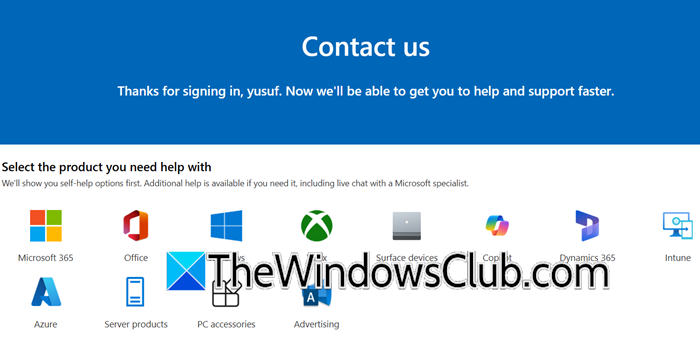

3] Contact Microsoft Support
If all else fails, we recommend you contact Microsoft Support. For this, you can go to support.microsoft.com, and then sign in to your account. Then, you can raise a ticket, discuss about your issue, and hopefully, you will receive a solution.
