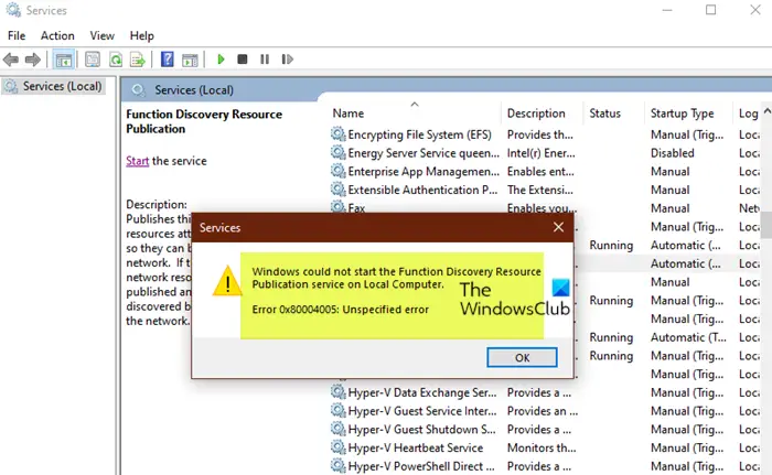

If Network discovery is turned off and not turning on, and you try to enable one of its dependency called the Function Discovery Resource Publication service on your Windows 11 or Windows 10 PC, you may get the error message Windows could not start the Function Discovery Resource Publication service on Local Computer – this post will help you with the most applicable solution to the issue.
What is Function Discovery Resource Publication?
The Function Discovery Resource Publication (FDResPub) publishes your computer and resources attached to your computer so they can be discovered over the network. If this service is stopped, network resources will no longer be published and they will not be discovered by other computers on the network.
When you encounter this issue on your device, you’ll receive the following full error message with code;
Windows could not start the Function Discovery Resource Publication service on Local Computer.
Error 0x80004005: Unspecified error
If you’re getting the Windows could not start the Function Discovery Resource Publication error message on your Windows 11/10 PC, you can try our suggested solution below to resolve the issue on your system.

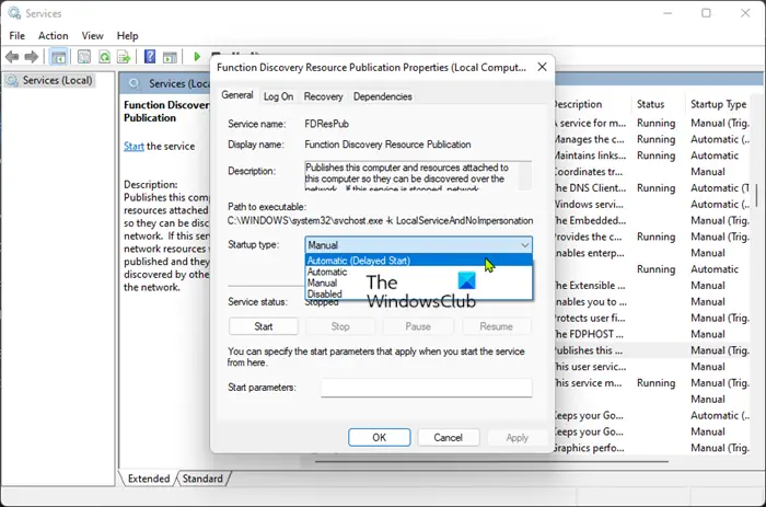

1] Change Function Discovery Resource Publication service Startup Type
This solution to Windows could not start the Function Discovery Resource Publication error message on your Windows 11/10 PC, reportedly worked for most affected users, and it requires you to make sure you’re logged in as admin and then change the Function Discovery Resource Publication service Startup Type on your device.
Do the following:
- In the Run dialog box, type services.msc and hit Enter to open Services.
- In the Services window, scroll and locate the Function Discovery Resource Publication service.
- Double-click on the entry to edit its properties.
- In the properties window, click the drop-down on the Startup type and select Automatic (Delayed).
- Click Apply > OK to save changes. The default is Manual.
- Restart PC.
