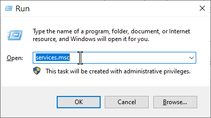

Open the Services Manager and check the status of the following services one by one. If you find any of these services disabled or stopped, enable and start them.
- UPnP Device Host
- Function Discovery Resource Publication
- SSDP Discovery
- DNS Client
If any of these services is stopped or disabled, double-click on it to open its properties. Now, select Automatic in the Startup type drop-down menu. After that, click Start if the Start button is clickable.

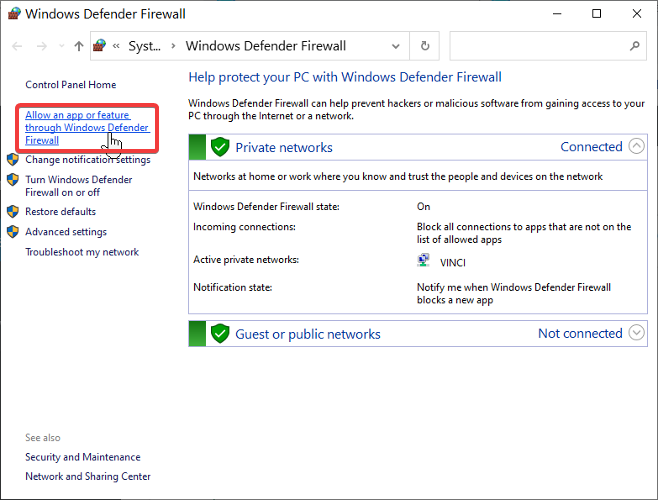

To enable Network Discovery, press the Windows Key and search for Windows Defender Firewall. Select Windows Defender Firewall from the results. Click on the Allow an app or feature through Windows Defender Firewall link on the left panel.

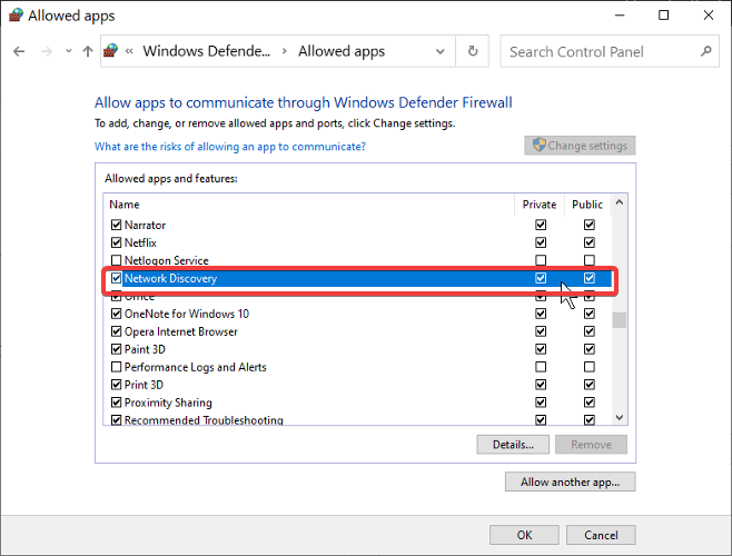

Hit the Change settings button. If prompted, sign in as an Administrator. Find Network Discovery from the list. Mark the checkbox on the left, as well as the Private and Public checkboxes at the extreme right.

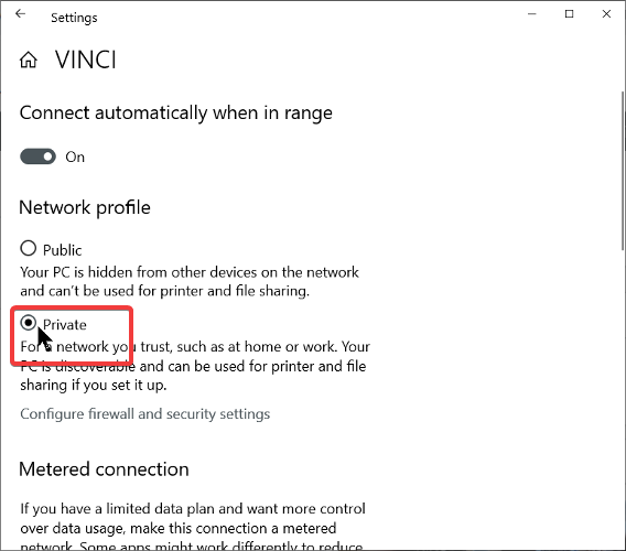

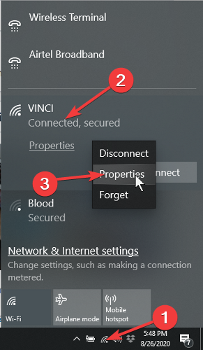

You can also try changing your Network Profile and see if it helps. Click on the network icon on your taskbar. Right-click on the network you want to fix and select Properties.
Select Private in the Network profile section.
Click on the back button at the top left-hand of the window. Navigate to Status on the left panel. Go to Sharing options.
Select Turn on network discovery. Mark the checkbox beside Turn on automatic setup of network-connected devices. Click Save changes.
