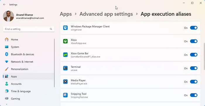

2] Change this Windows Terminal setting
Another thing that causes the problem is this setting. Here are the changes you need to make to solve the problem.
- Open the Settings window by pressing the Windows + I shortcut key.
- Click on Apps present on the left panel of the screen.
- Choose Advanced app settings.
- Now click on App execution aliases.
- Locate the Terminal and toggle On the option
- If the Toggle is already set to On, move it to Off, and then after a few seconds change it to On again.
Now, exit the window and see if this has helped.
