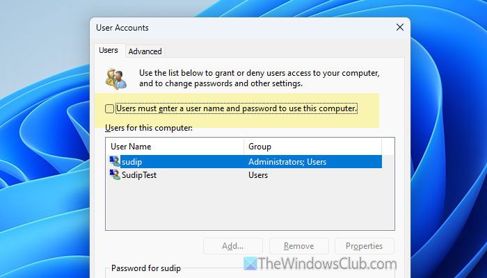

2] Disable auto logon
A setting lets you sign into your system without entering the username and password. If this setting is turned ON, there is a chance of getting the problem above at times. That is why we would suggest that you disable auto logon using these steps:
- Type netplwiz and hit the Enter button.
- Select a user.
- Remove the tick from the Users must enter a username and password to use this computer checkbox.
- Click the OK button.

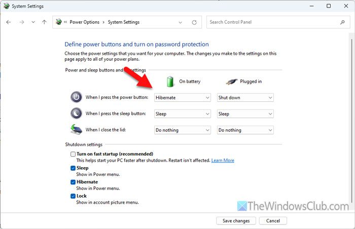

3] Check Power button setting
At times, this issue may arise due to an incorrect setting, and it is related to the power button. If you have set a different power setting for the power button, it won’t shut down your PC, and the user will stay online. That is why we would recommend you check the power button setting by following these steps:
- Open the Control Panel and click on Power Options.
- Click on the Choose what the power buttons do option.
- Expand When I press the power button menu.
- Choose Shut down for both power states.

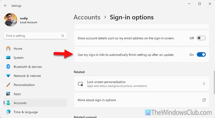

5] Don’t use sign-in info to auto update
Windows 11 uses your sign-in information to install and set up an update. However, this particular setting could be responsible for this error. That is why you should follow these steps to disable this setting:
- Go to Accounts > Sign-in options.
- Toggle the Use my sign-in info to automatically finish setting up after an update button to turn it OFF.

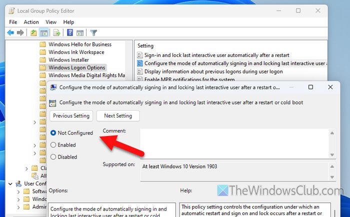

6] Check Group Policy setting
A Group Policy setting lets you configure the state of auto sign-in and lock the last interactive user. If this policy is turned ON, you might face the abovementioned problem. To disable this setting, follow these steps:
- Press Win+R > type gpedit.msc and hit the Enter button.
- Navigate to Computer Configuration > Administrative Templates > Windows Components > Windows Logon Options.
- Double-click on the Configure the mode of automatically signing in and locking last interactive user after a restart or cold boot setting.
- Choose the Not Configured option.
- Click on Apply and OK.
