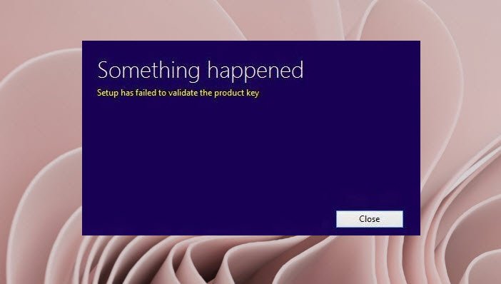

When trying to install, repair, or upgrade Windows using the ISO files, we are getting an error when the Setup utility runs. The setup initiates fine but after the “We’re getting some things ready” screen, it gives the following error.
Setup has failed to validate the product key
In this post, we will see what you can do if the Setup fails to validate the product key in Windows 11/10.
Windows 11/10 Setup has failed to validate the product key
If you get the “Setup has failed to validate the product key” error, follow the solutions given below.

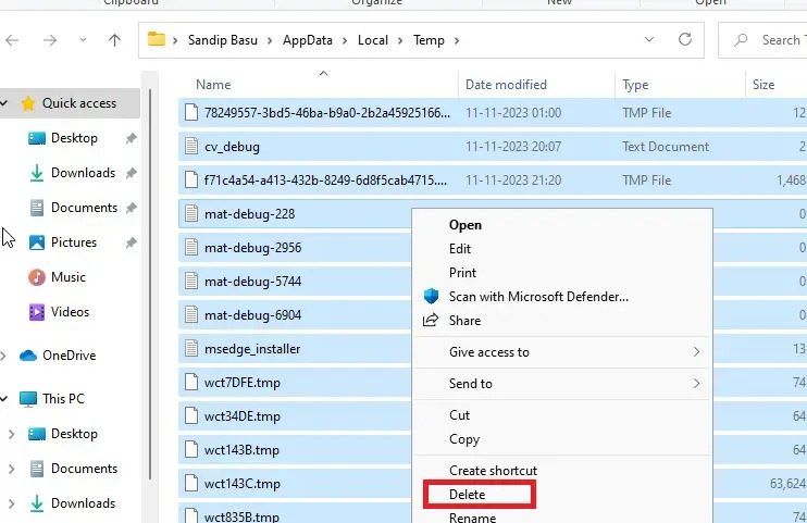

3] Delete the temporary files
Delete the temporary files. To do so, press Win + R to open the Run window and type temp. Press Enter to open the temporary files window and delete all the files.
Repeat the process with the Run commands %temp% and prefetch.
