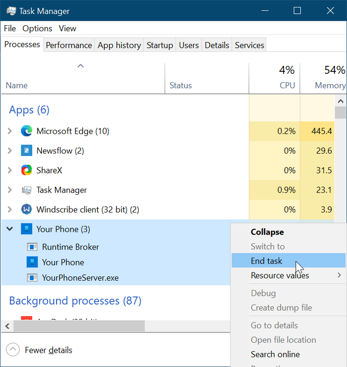

1] Restart all the Your Phone application processes
As usual, we’ll troubleshoot the application from the most straightforward solution. In this case, let’s start by restarting all the processes related to the Your Phone Application. We’ll do this via the Task Manager.
Press the CTRL+SHIFT+ESC key combination to open the Task Manager. Next, find Your Phone under the Processes tab and right-click on it. Select End task from the context menu to close this process.
Doing this ends all the processes running under it, such as Runtime Broker, Your phone, and YourPhoneServer.exe.
Allow the processes to close completely, and then relaunch the Phone Link app. If a minor bug or error caused the issue, restarting the process will fix it, and you should begin to hear phone call audio. However, if this solution fails, continue to the next one.
