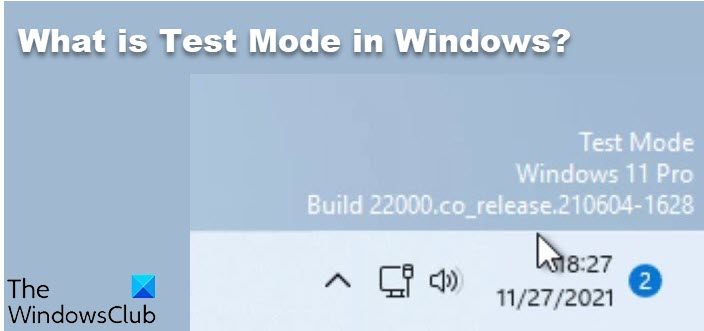

Windows OS has several watermarks that appear when certain situations warrant it so. One of them is the Test Mode watermark. This watermark may appear in the bottom right part of your Windows desktop if you install an application whose drivers are not digitally signed by Microsoft and if they are still in the testing phase.
What is Test Mode in Windows
Most are familiar with For testing purposes only, Evaluation copy, Safe Mode, etc watermarks. The Test Mode is not so familiar a watermark, however!

- Displays a watermark with the text “Test Mode” in all four corners of the desktop, to remind users the system has test-signing enabled. However, starting with Windows 7, Windows displays this watermark only in the lower left-hand corner of the desktop.

If, in the rare eventuality, you get to see the Test Mode | Windows | Build watermark on the bottom right part of your Windows desktop, for reasons unknown to you, you may have to re-enable driver checking first. Open a Command Prompt as an Administrator and enter the following commands:
