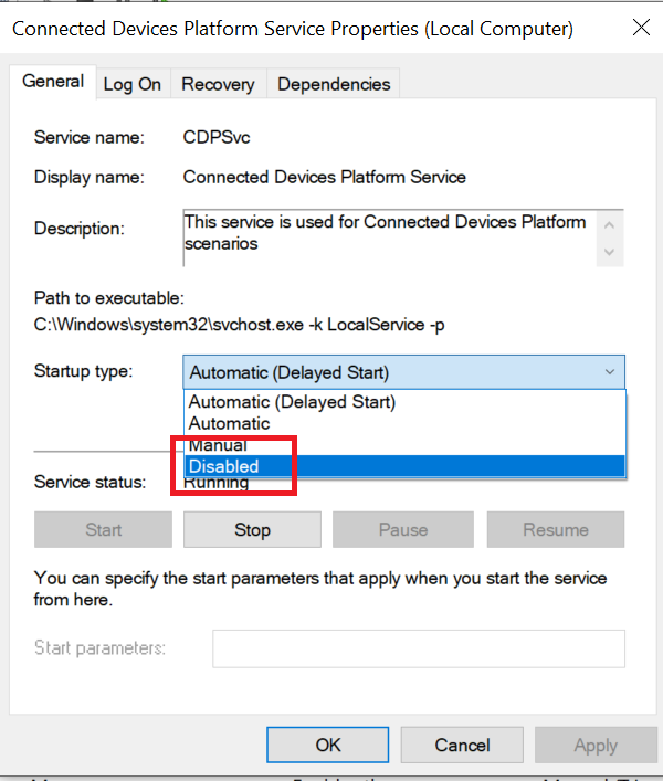

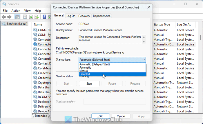

1] Disable Connected Devices Platform Service using Services Manager

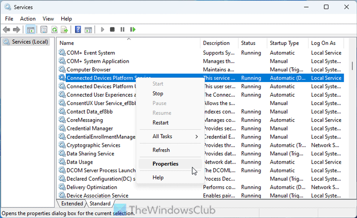

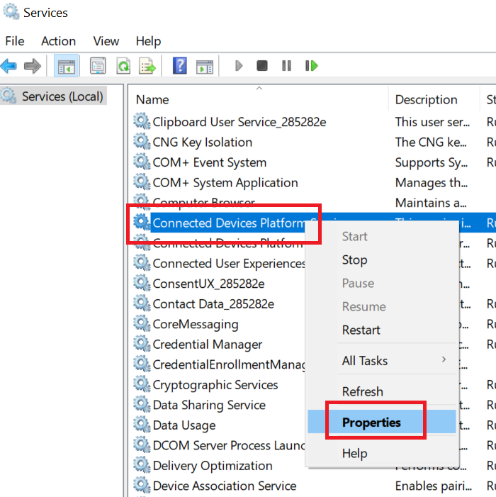

Press Win+R to open the Run window and type the command services.msc. Hit Enter to open the Services Manager window.
Scroll to the Connected Devices Platform Service in the list and right-click on it. Select Properties.
Change the Startup Type of this service to Disabled.
Hit Apply and then on OK to save the settings.

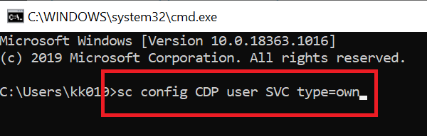

You can disable the Connected Devices Platform Service using a command line in an elevated Command Prompt or Terminal. The procedure to do so is as follows:
Search for Command Prompt in the Windows Search bar and select Run as administrator in the right pane.
Alternatively, you can press Win+X and select the Terminal (admin) option. Then, make sure that you have opened a Command Prompt instance.
In the elevated Command Prompt/Terminal window, type the following command and hit Enter:
sc config CDP user SVC type=own
Restart the system after the command has been executed.

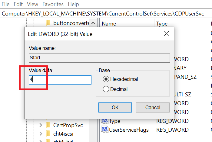

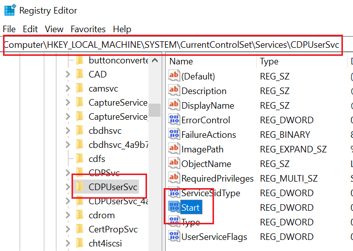

Press Win+R to open the Run window. In the Run window, type the command regedit. Hit Enter to open the Registry Editor window.
Navigate to the following path:
Computer\HKEY_LOCAL_MACHINE\SYSTEM\CurrentControlSet\Services\CDPUserSvc

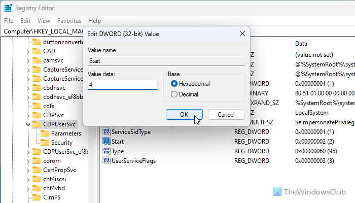

On the right pane, double-click on Start to open its Properties.
Change the value of the Value Data from 2 to 4.
Click OK to save the settings.
