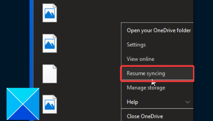

Resuming OneDrive syncing is the simplest thing to do when accessing a file. Follow the steps outlined below:
- In the system tray on your computer (you may need to expand the tray to see hidden icons), right-click on the OneDrive icon and select Help & Settings.
- In the context menu shown, click on Resume syncing.
- Let the syncing process complete, then restart your computer.

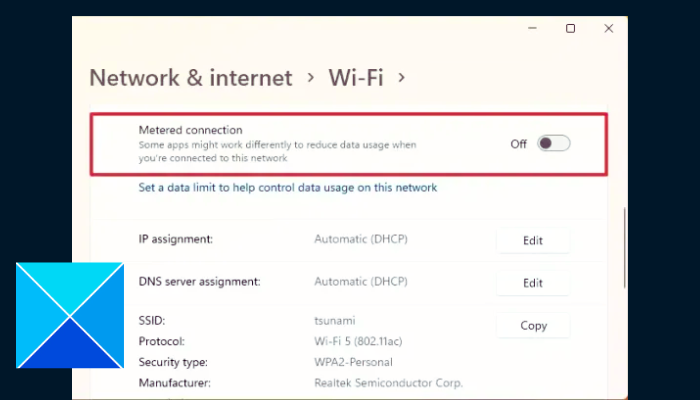

The metered network feature can hinder the syncing process in OneDrive. Therefore, please disable it to ensure a smooth process. Follow the steps outlined below:
- Press the Windows key + I go open Settings, then navigate to Network & Internet.
Click on Wi-Fi or Ethernet, depending on the internet network you are connected to. - Now, click on the specific network you are connected to and turn off the toggle in front of Metered connection.

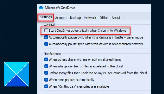

- Right-click the OneDrive application icon in the system tray and select Help & Settings, then click on the Settings option from the context menu.
- Under the General section, checkmark Start OneDrive automatically when I sign in to Windows.

- Right-click on the OneDrive app icon in the system tray, then click on Help & Settings. Click on Settings from the context menu.
- Under the Files On-Demand section, uncheck the “Save space and download files as you use them” option.
- Under the General section, uncheck “Automatically pause sync when this device is in battery saver mode” and “Automatically pause sync when this device is on a metered network”.

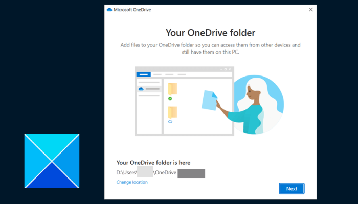

- Restart your computer and open OneDrive. Sign into your account.
- On the “Your OneDrive folder” screen, click on Change location under “Your OneDrive folder is here”.
- Set the location to default path, create a new folder to avoid files conflict.
- Restart your computer after everything.

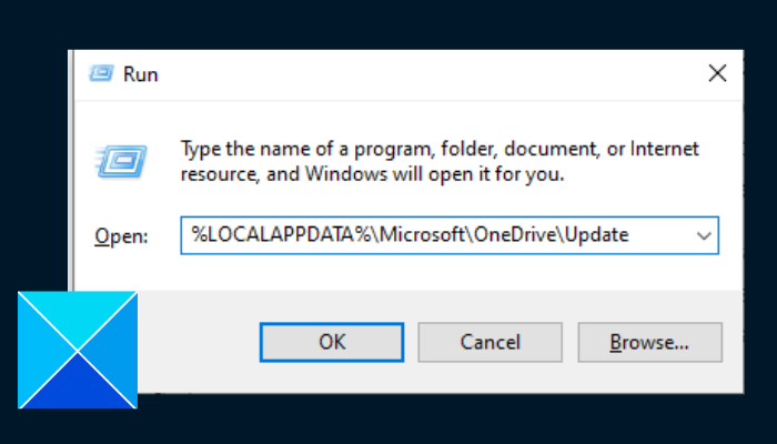

- Press the Windows key + R to open the run dialog box, then enter the following: %LOCALAPPDATA%\Microsoft\OneDrive\Update
- Check if there is OneDrive.exe in the folder that just opened, then run it to set up OneDrive for first use.
- If not, enter the following into the run dialog box again: %LOCALAPPDATA%\Microsoft\OneDrive\
- Restart your computer subsequently.
- If the problem persists, enter the following into the run dialog box again: %localappdata%\Microsoft\OneDrive\onedrive.exe /reset
