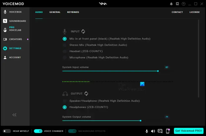

3] Check your input and output devices in Voicemod
Check if you have selected the right input and output devices in Voicemod. Some users were not able to hear themselves in Voicemod. When they checked, they found that they had selected the wrong output device. The steps to configure input and output devices in Voiceod are written below:
- Launch Voicemod.
- Select Settings from the left side.
- Select your input and output devices under the Audio tab.

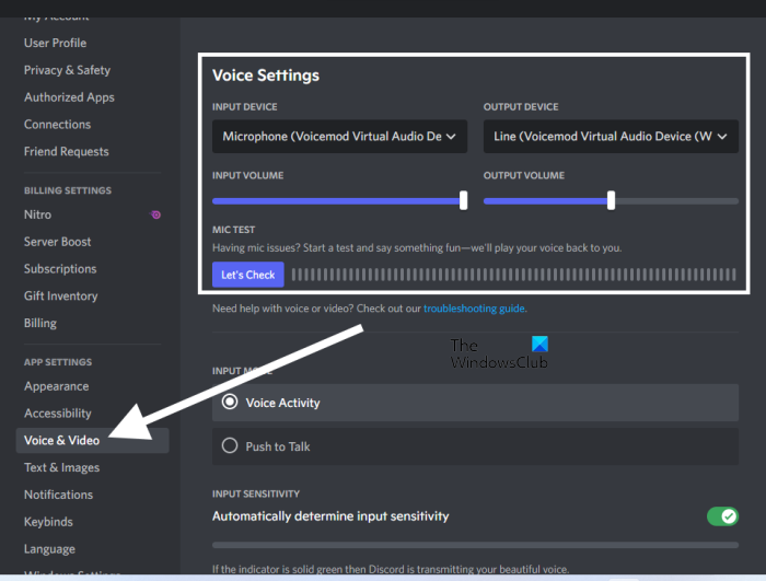

How to configure Voicemod in Discord
The steps to configure Voicemod in Discord are as follows:
- First, open Voicemod.
- Now, open Discord.
- Open User Settings by clicking on the gear-shaped icon on the bottom left side.
- Select Voice & Video from the left side.
- Click on the INPUT DEVICE and OUTPUT DEVICE drop-down menus to select Voicemod Virtual Audio Device.
- Move the sliders to adjust input and output volumes.
If you are still experiencing issues with Voicemod in Discord, open Discord settings and select Voice & Video from the left side. Now, disable the following options.
- Automatically determine input sensitivity. After disabling this option, move its slider to the left (-100 dB).
- Noise Suppression.
- Echo Cancellation.
- Noise Reduction.
- Automatic Gain Control.

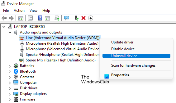

6] Reinstall Voicemod driver
The corrupted or outdated Voicemod driver also prevents Voicemod from working fine. You can fix this problem by reinstalling the Voicemod driver. The steps to do this are as follows:
- Press the Win + X keys and select the Device Manager.
- Expand the Audio Inputs and Outputs node.
- Right-click on the Voicemod driver and select Uninstall device.
- Click Uninstall in the confirmation box.
- After uninstalling the driver, restart your computer.
Windows will detect the hardware changes automatically on the restart and install the Voicemod driver automatically. If the driver is not installed automatically, open the Device Manager and go to “Action > Scan for hardware changes.” This will install the missing Voicemod driver.

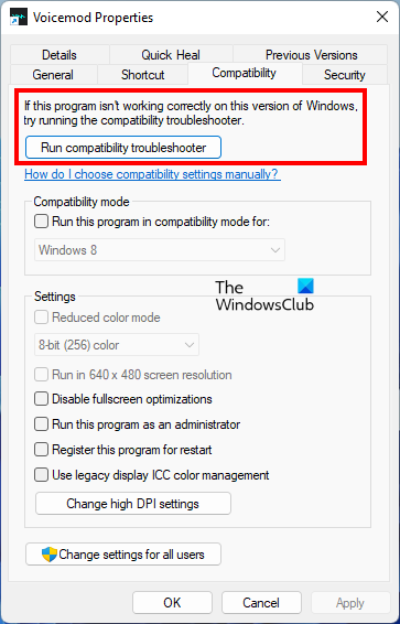

7] Run Program Compatibility Troubleshooter
The Voicemod might not be working properly or changing voice due to compatibility issues. Running the Program Compatibility Troubleshooter can help. Follow the steps provided below:
- Close Voicemod if it is already running.
- Open the Task Manager and kill the Voicemod background process.
- Right-click on the Voicemod desktop icon and select Properties.
- Select the Compatibility tab and click on the Run the troubleshooter button.
The above steps will launch the Program Compatibility Troubleshooter. Let the troubleshooter detect and fix the problem. If it does not fix your problem, run Voicemod in compatibility mode.

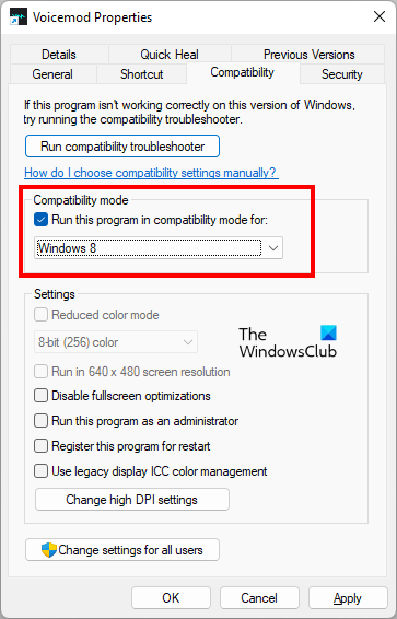

8] Run Voicemod in Compatibility mode
If the Program Compatibility Troubleshooter fails to fix the problem, go through the following instructions to run Voicemod in compatibility mode.
- Close Voicemod and kill the Voicemod background process by using the Task Manager.
- Right-click on the desktop icon of Voicemod and select Properties.
- Under the Compatibility tab, select the “Run this program in compatibility mode for” checkbox.
- Select Windows 8 in the drop-down.
Now, launch Voicemod and check if the issue is fixed. Running Voicemod in compatibility mode has fixed the problems of some users.
