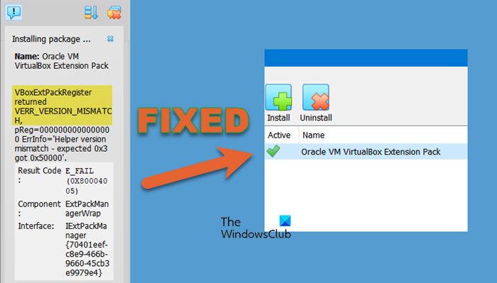

When trying to install the extension package in VirtualBox, you may get a VERR_VERSION_MISMATCH error due to compatibility issues. In this post, we will see what to do if VBoxExtPackRegister returned VERR_VERSION_MISMATCH in VirtualBox.
Fix VBoxExtPackRegister returned VERR_VERSION_MISMATCH in VirtualBox
The error message indicates that there is a disparity between the extension and VirtualBox versions. This can be because either of them is outdated or the extension installed has some corrupted files prohibiting the upgrade.
If you get VBoxExtPackRegister returned VERR_VERSION_MISMATCH in VirtualBox, follow the solutions mentioned below.

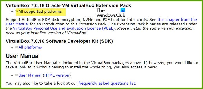

3] Install the latest version of the Extension Pack
Sometimes VirtualBox fails to install the correct extension pack or even recognizes that a package already exists. In that case, we are going to download a new instance of the Extension Pack from their official website and install it. Follow the steps mentioned below to do the same.
- Open a browser and navigate to virtualbox.org.
- Look for the VirtualBox Extension Pack and then download the latest version of the Extension Pack.
- Once done, open VirtualBox and navigate to Files > Tools > Extension Pack Manager.
- Select the problematic package and click on Uninstall.
- Once it’s removed, click on Install, navigate to the path where you have downloaded the package, and select it.
It will install, hopefully, without any errors.

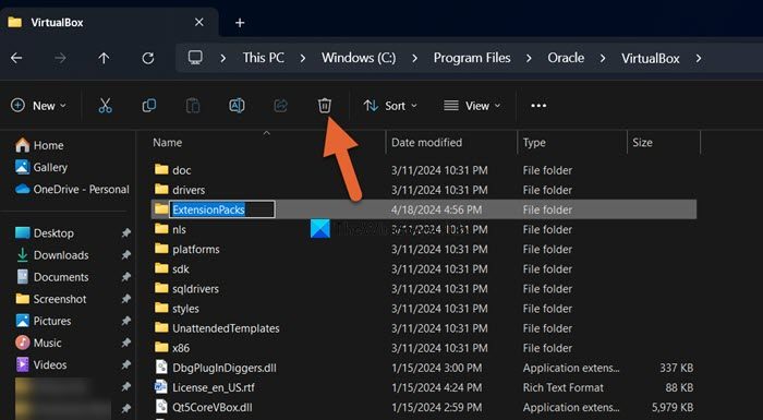

4] Delete the ExtensionPacks
If you are facing issues with the installation of the VirtualBox extension, try deleting the folder where these extensions are installed and then retry the installation. By default, the ExtensionPacks folder is located at C:\Program Files\Oracle\VirtualBox. Therefore, you will need to delete this folder and then reboot your computer. Once done, you can go ahead and install the latest ExtensionPack.
