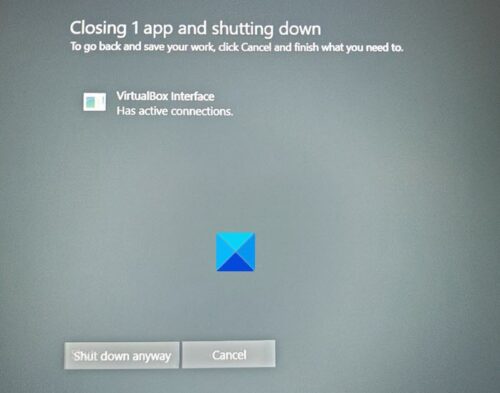

In this article, we will describe the methods to fix the issue where VirtualBox Interface won’t allow PC to shut down. Some users have reported that they have experienced such an issue on their Windows 10 computers. According to them, every time they turn off their system, a program, “VirtualBox Interface” prevents it from shutting down. The weird thing is that they have not installed this type of program on their computer.
Fix VirtualBox Interface has active connections error message
You may get this error if you have installed the BlueStacks emulator on your computer. Because users get the message, “VirtualBox Interface is still active,” while shutting down their system, they cannot identify that it is BlueStacks that is preventing their system from turning off. There may also be some other causes of the issue, but in most cases, the error was caused by BlueStacks.

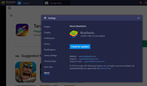

3] Update or reinstall BlueStacks
If you have an older version of BlueStacks, you may encounter this problem. This is because the older versions of the software may have bugs that prevent your system from shutting down.
Follow the steps below to update BlueStacks:
- Launch BlueStacks on your computer.
- Click on the Settings, available on the bottom right side of the software.
- Click About on the left side.
- Click Check for updates.
After updating the emulator, shut down your system and see whether the VirtualBox Interface prevents your computer from turning off or not.
If it doesn’t fix the issue, uninstall and reinstall it again by downloading the latest version from its official website.
