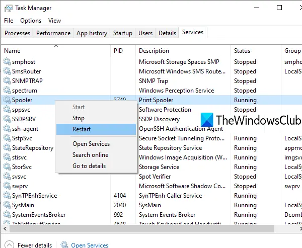

1] Restart the Print Spooler Service
Print Spooler (executable file) is a built-in feature of Windows that handles print jobs. The service usually works just fine, but sometimes, an issue related to it may cause unknown errors, such as the one described above.
In that case, you’ll need to restart the Print Spooler service using Windows Services Manager. Launch Services Manager, locate Spooler service, right-click on it and select Restart.
You can also restart the Print Spooler service using Task Manager.

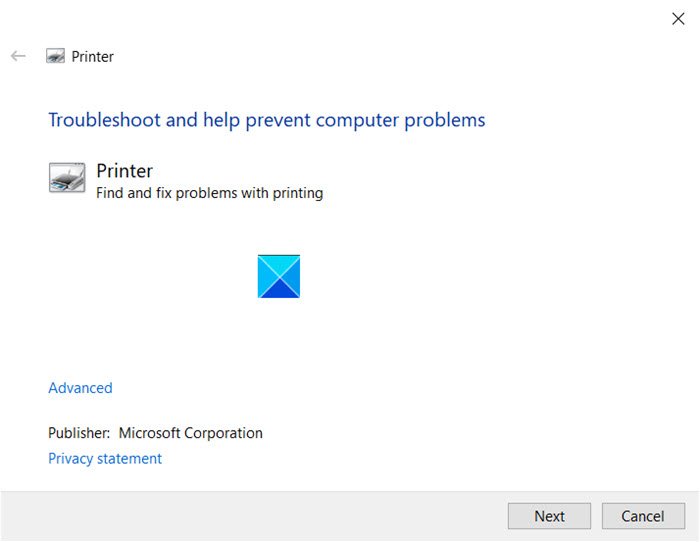

2] Run Print Troubleshooter
The Printer Troubleshooter detects and automatically fix most issues related to printers. Simply launch the utility, select Printer from the list, and then click the Next button to begin the troubleshooting. It checks for:
- Printer Driver updates are available if any.
- Scans for Printer connectivity issues.
- Print spooler service errors.
- Printers that are not shared with the HomeGroup.
- Printer queue.
