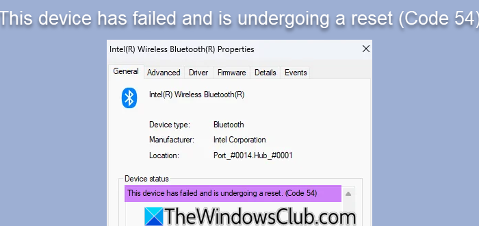

Sometimes Windows or the device itself has to restart. While it’s usually fast, but if you managed to catch a device in such a state, it gives an error Code 54. This post will help you resolve this Device Manager error code.
Fix Error Code 54, This device has failed and is undergoing a reset
This is an intermittent problem code assigned while an ACPI reset method is being executed. While it will automatically resolve itself in a while, if the device never restarts due to a failure, it will be stuck in this state, and the system reboot is required. Here are some suggestions you may try.
