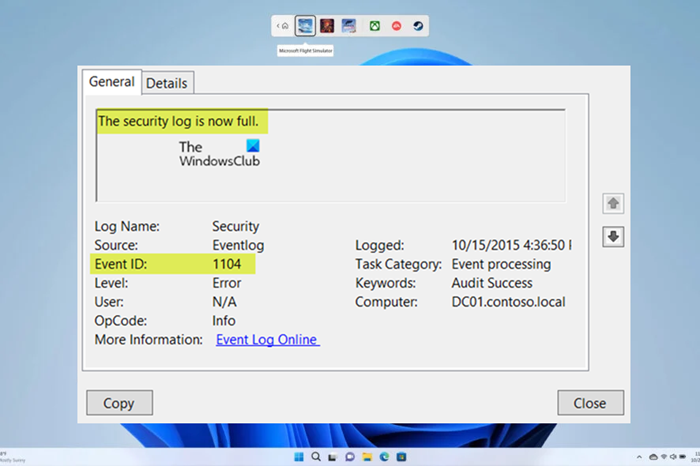

In Event Viewer, the errors logged are common, and you will come across different errors with different Event IDs. The events that are recorded in the security logs usually will be either of the keyword Audit Success or Audit Failure. In this post, we will discuss The security log is now full (Event ID 1104) including why this event is triggered and the actions you can perform in this situation whether on a client or server machine.
As the event description indicates, this event generates every time the Windows security log becomes full. For example, if the maximum size of the Security Event Log file was reached and the event log retention method is Do not overwrite events (Clear logs manually) as described in this Microsoft documentation. The following are the options in the security event log settings:
When the upper limit of the Security Log Event file size is attained, and there is no room to log more events, the Event ID 1104: The security log is now full will be logged indicating that the log file is full, and you need to perform any of the following immediate actions.

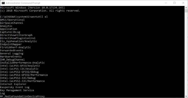

3] Manually clear the Security Log
If you have set the retention policy to Do not overwrite events (Clear logs manually), you will need to manually clear the security log using any of the following methods.
- Event Viewer
- WEVTUTIL.exe utility
- Batch file
