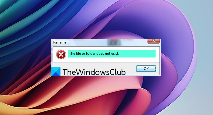

If when you try to move or rename files or folders on your Windows computer, you cannot move or rename files or folders, you get the error message The File or Folder does not exist, then this post will help you fix the problem on your Windows Vista or Windows 10/8/7 machine.

Unable to move or rename file or folder in Windows
