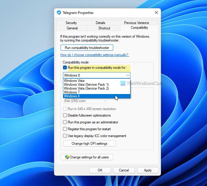

1] Run in Compatibility mode
If you are using a Beta or Insider version of Windows 11/10, you will get such an error on your computer. If the Telegram app doesn’t comply with your system, you might get this problem while opening it. The simplest solution is the Compatibility mode, an in-built functionality that helps you open programs that fail to open independently. To open the Telegram app in Compatibility mode, do the following:
- Create a desktop shortcut for the Telegram app.
- Right-click on the icon and select the Properties option.
- Switch to the Compatibility tab.
- Tick the Run this program in compatibility mode for checkbox.
- Select Windows 8 from the list.
- Click the OK button.
- Run the program on your computer.
If it fails to open the Telegram app, check out other solutions.

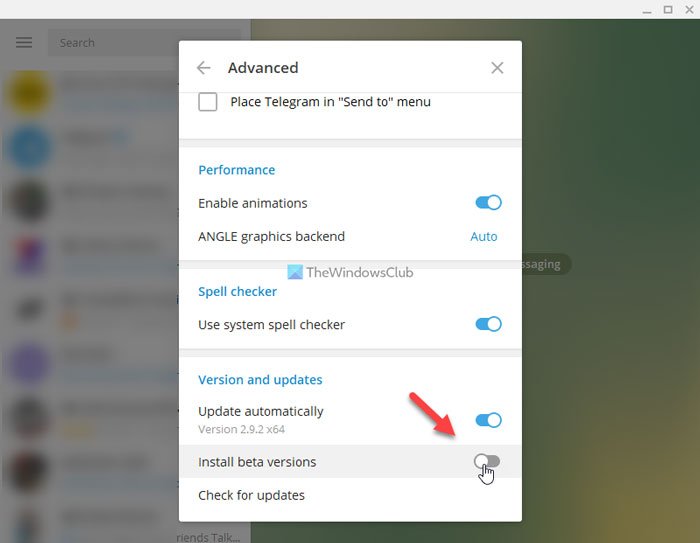

3] Opt-out of beta version
This particular solution works only when you can open the Telegram app for a few seconds. If this app is frequently crashing, maybe the latest beta version is causing the issue. At times, the beta version users get this problem while using the Telegram app on their PC. If you opted for the beta version, it is the right time to opt-out of it. For that, do the following:
- Click the hamburger menu visible on the top-left corner.
- Go to Settings > Advanced.
- Toggle the Install beta versions option.
You may also disable the automatic update temporarily.
