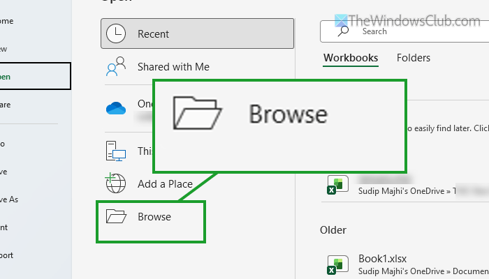

4] Re-open closed Workbook
At times, Excel makes a blunder when you have multiple workbooks, each containing many worksheets. If that happens, there is a very simple solution:
- Close the current workbook. You can close Excel for that.
- Next, open Excel on your computer.
- Click on File > Open and choose the Workbook.
- Try running the same VBA script.
